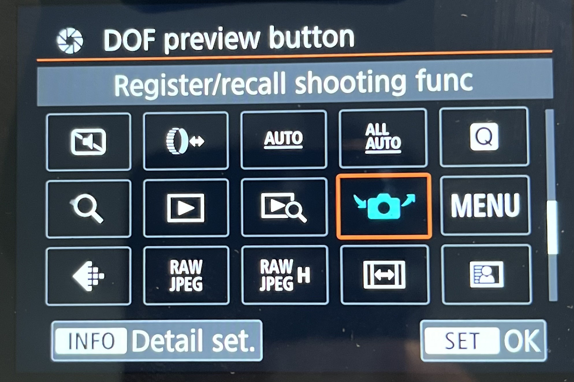

Register/recall is the bomb for a fast and temporary configuration change. Just hold down the assigned button (I use DOF preview) and you get a slate of new settings. The list is heavy on the AF and exposure options, and omits things like shutter mode, AEB, and drive mode, but if the configuration you want is covered by the list then it's really cool. Way faster than using a C mode. I have a "snapshot" mode programmed so that no matter what I am doing I can have 1/125, f/5.6, AWB, Auto-ISO, and a few others at the touch of a button.
Customize buttons - choose your button - register/recall shooting func - detail set - then enable and set the options you want.

Thanks again. I wonder if menus on R7 and R10 are'nt the same, as I can't find having any Register/recall option. Or I just don't find it due to language - my menu is in Norwegian.
