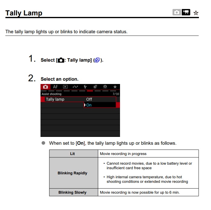

I have twice noticed the red light in the front of the camera, usually solid when videoing, start flashing but that's it. I wonder if it is a connectivity fault in the camera.

I looked it up in the R6 Mk III Advanced User Guide and on page 403
Thanks for this. I had wondered if it was because the camera was overheating although it seems to do this after a very limited amount of time, just minutes in. I didn't know the annoying front light was called the Tally Lamp so I've learnt something. I've managed to switch it off in Movie mode but it still lights up when I video in camera mode. Another disappointment.
I'll keep practicing to see just how long I have before the camera either stops recording video (up to six hours? Really?) because of overheating, both in Standard mode and High mode for Auto Power Off.
This helps me think there is nothing wrong with camera or cards but unlike the R6 MkI this beast cannot cope with prolonged use beyond about 20 minutes without a break. No good for my usual two hour model shoots but I'll just have to adjust somehow.
