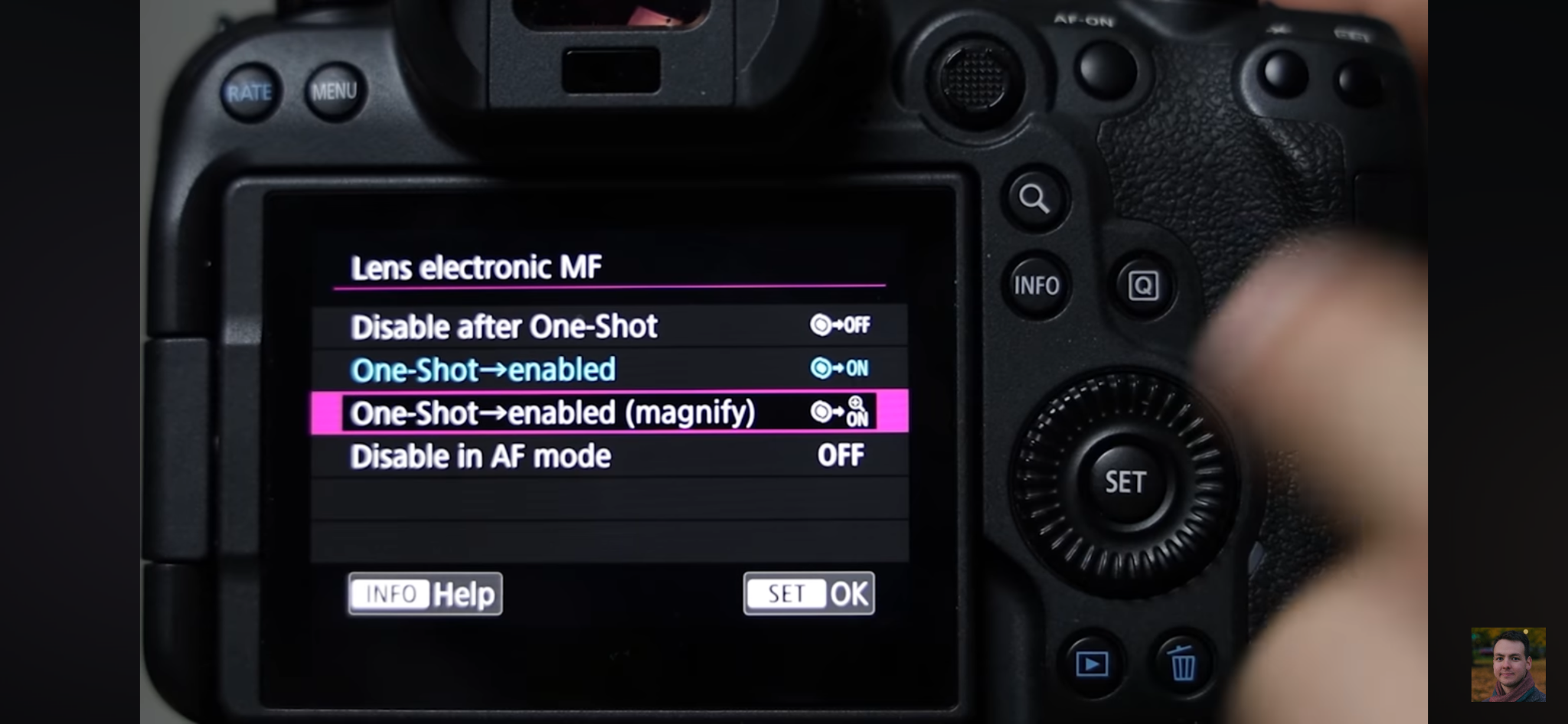

Yes. I've set this up for both my R5 and Karen's R7. One example use-case would be where we're at the zoo (typically using Servo AF/ Face + Tracking) and the AF just cannot find the desired target, we'd have an alternative set-up available (via the AF-ON button ) which switches things over to 'One-Shot->enabled (magnify)' so we can then attempt to manually focus on the subject - with the added magnification greatly assisting the fine-tuning process.

I do not think that this works if you use back button focus. I use always Servo so I do not think that this will work either in that mode. I can adjust focus manually at any time if I stop pushing the back button in my case. What I usually do is to click in the Magnify Button and then turn the Focus Ring in the lens to achieve focus.
Actually, it does. It does say “One Shot” though so it doesn’t work with continuous focus.
You don’t get Focus Peaking or the Focus guide though.

I’ve only just begun playing with it, so I am by no means an authority on it, but for macro, I was pressing my back button -and the camera’s - to rough autofocus then pressing and holding the button and turning the focus ring.
No matter what I do, I can't get that option to work using back button focus.
Following up on my earlier post regarding our set-up, I have configured the (AF-ON) button via the 'Customise buttons' Menu and 'AF-ON' option as follows -
AF-ON = 'Metering and AF Start', plus - crucially (via the 'hidden area' accessed using [INFO Detail set.] when still on the AF-ON button options screen) - AF Operation = 'One Shot', AF method = 'Expand AF area: Around' and Servo AF characteristics = '1'.
This, in combination with setting 'One-Shot->enabled (magnify)', enables the user to switch to this alternative (non-latching) set-up using the (AF-ON) button.
Hopefully this additional information will be helpful in clarifying this aspect of our (AF-ON) button set-up. :)
I gave up,
I still achieve the same by clicking in the magnifying glass button and then the focus control ring in the lens.
You are clearly unworthy of your camera. Please box it up and send it to me.
Are you holding the back button (in my case “AF-ON”) while turning the focus ring?
Yes, I do. Question, are you using an EF lens or a RF? Regarding sending you my camera I’ll do that as soon as I receive your money order for the amount of $2000 ;)
RF - 85, at the moment. R5, Single spot AF, One Shot AF, 2 second self timer…evaluative metering…
Press and hold the AF-ON button…and as soon as I touch the focus ring, it jumps to zoomed view and I get a flashing “MF” on the left side of the LCD.
If all that rings true, there’s got to be something in the menus we’re missing.
The check is in the mail. 😉
I think that the issue is with using an EF lens.

I do use magnification and manual focus from time to time when AF is really hard (birds hidden behind branches) but all I do is, stop pressing my AF/ON button, press the magnifying button, and turn the focus ring on my lens. This, works for me. But this described scenario is something that I may use once in few weeks. I do not depend on magnification for my photos. I depend on Servo Mode, Eye AF and Subject Tracking.

Actually, I was most interested in it for macro/closeup work, but the loss of the focus aid and focus peaking makes this “feature” of limited use to me. It might work for landscape. Still, it was a simple change for me and it doesn’t really impact anything else. So, someday, if I even remember it exists, I may use it. Maybe.
