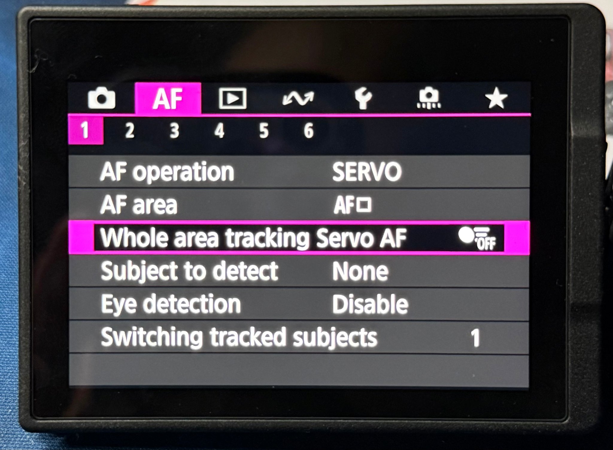

Hi all, I hope this is in the right area, (and apologies if not! 😇)
I am struggling to get my head around the new Autofocus system/tracking. It doesn't help I've only had 1 real trip out with the new R6 II since getting it 3 months ago! But, I am struggling to understand how to get it correctly setup, so I am after any pointers/tips/other threads people may have from photographing aviation before! The YouTube world is a bit of a minefield.
Currently, I've got it setup so that within the AF Menu settings, "Whole area tracking Servo AF" is off, "Subject to detect" is None. I also have Case 2 setup for aviation following other people's advice.
I've got my AF-ON button set to 1-Point AF (used to this from 90D days!) then the * AE Lock set to "AF on detected subject" which I figure I would use for airborne shots where it can automatically pick up the aircraft in the sky, and lastly AF Point Button set to "AF Point Selection" so that I can easily change AF points for different use case.
I know that the best learning tool is just to get out to try, but it's such a big learning curve! So I just want to see if I am starting in the right area 😆 Airshow season is a couple of month's away, and not able to get much time at local bases in Suffolk currently.
Thanks very much in advance!

Thanks for coming back to me, much appreciated. There is a very good chance that I am making this much more complicated than I need to be! I've got myself into a habit of "over-complicating" things, so wouldn't be surprised if that's what I have done here.
So within the 'Pink' AF menu, sub-menu '1', Servo is enabled, and for me the 3rd option down does show as "Whole area tracking Servo AF". I wasn't sure if this was correct to have off, or not.

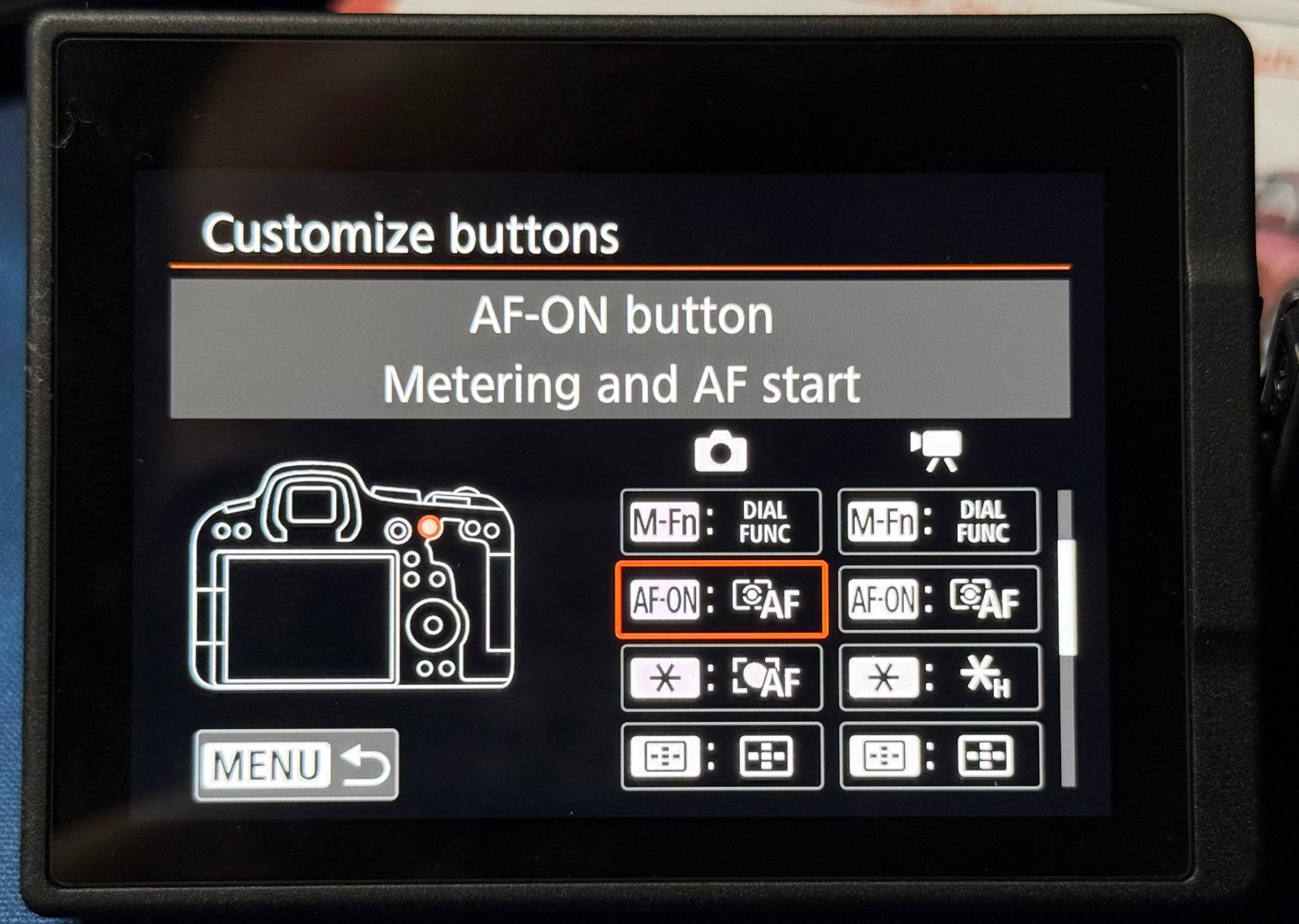

I am not sure I have the back-buttons set correctly, or not...
AF-ON - Metering and AF Start
AE Lock - AF on detected subject (I changed this earlier)
AF Point button - AF point selection
