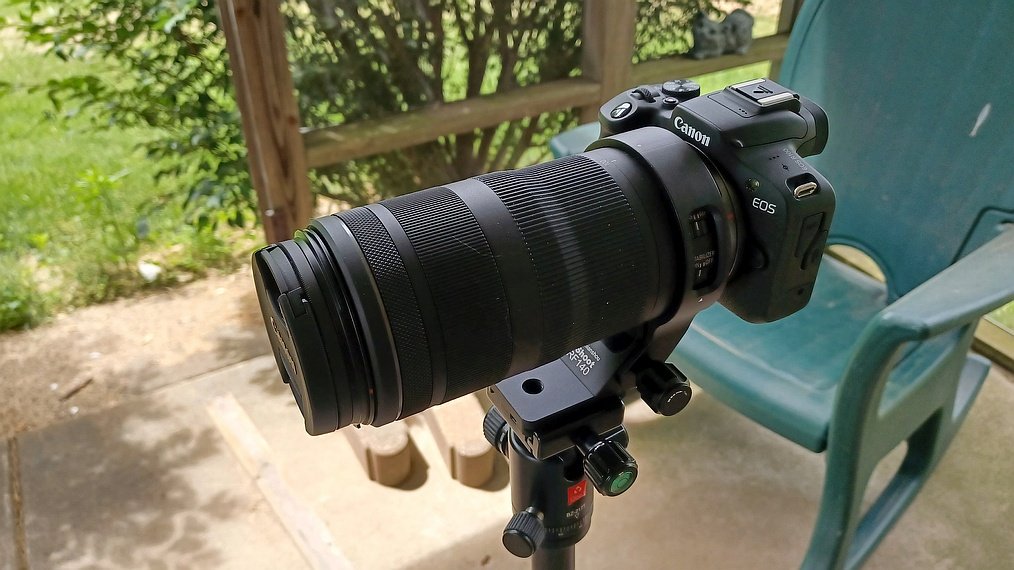

Thank you, everyone, for the suggestions. I ended up with the iShoot bracket recommended by Stephen. The R100 camera and lens combo balances very well on my also new Oben travel tripod.
The bracket is nicely made and fits the lens perfectly. The soft insert should prevent any scratching, though I can't imagine wanting to remove it, and it will be some time before I will likely sell the lens and worry about resale value. One minor nit-pick is I might have preferred a hex or torx head screw for the ring tension instead of the big knob. My Oben travel tripod mounts it perfectly with the Arca-style attachment.

I have used the lens/bracket combination several times around the rural area where I live. I have an Oben portable tripod. The bracket makes a massive difference in framing a shot because the camera/lens combination is balanced very well. I have not specifically tried it with my tripod in the Monopod configuration, but as nose-heavy as the camera/lens was with a tripod attached to the camera, I am pretty confident it would help. Disclaimer: I have minimal experience using a monopod with longer, heavier lenses.
