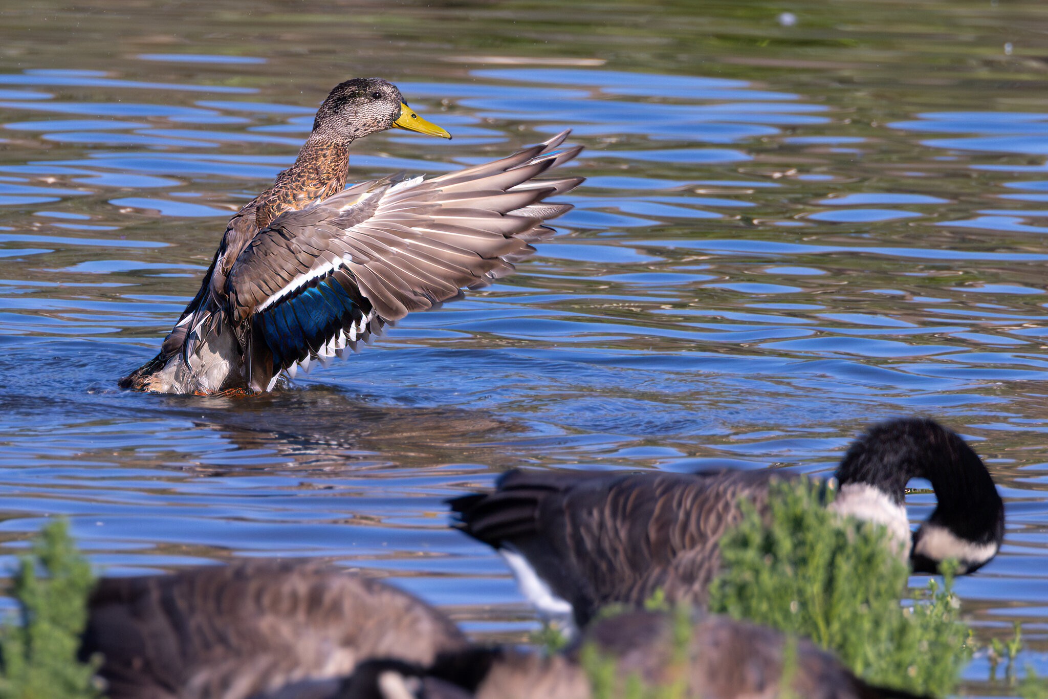

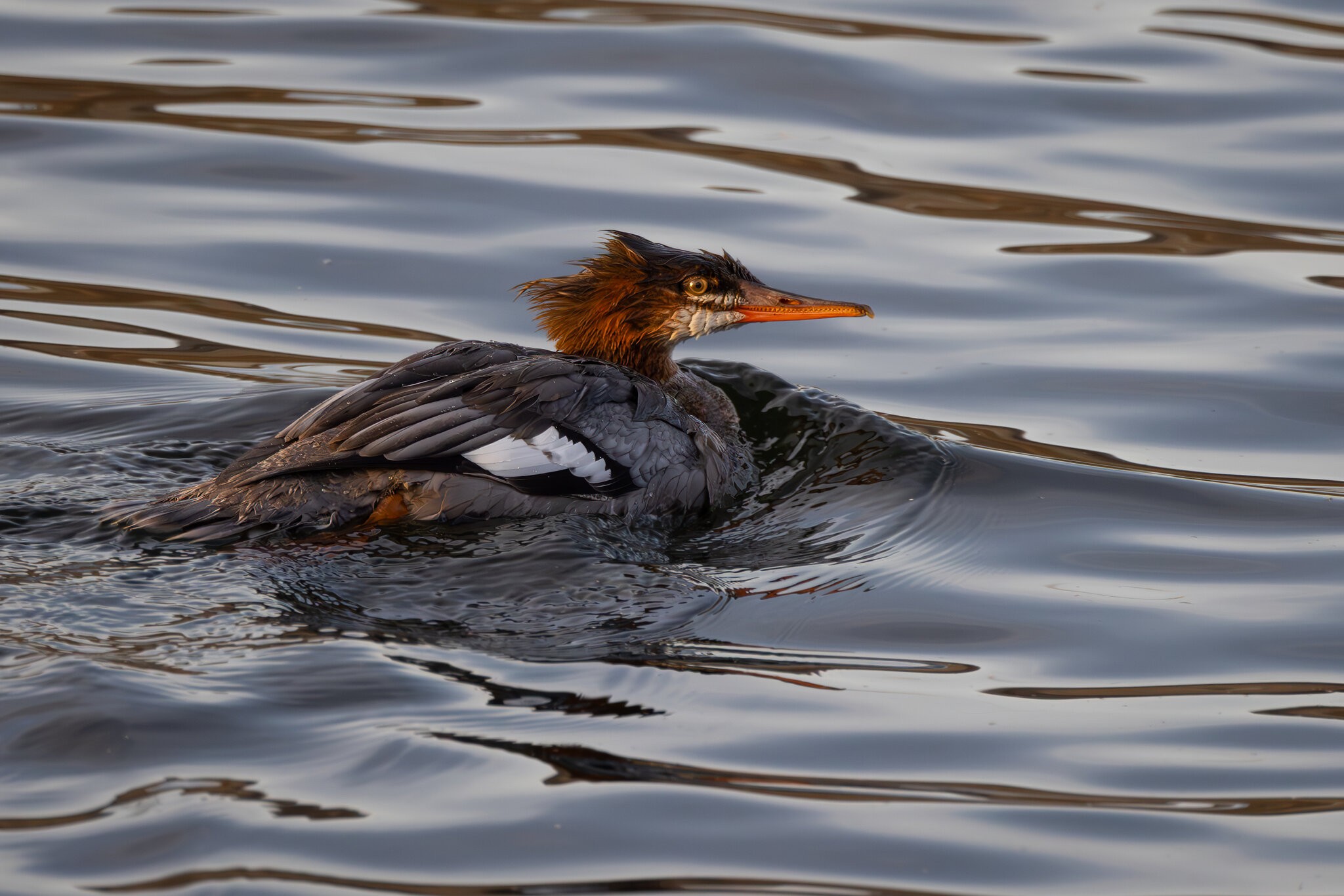

Late reply... I have been using crop mode quite a bit lately. So 500mm @ 1.6 crop mode gives me an effective focal length of 800mm. Yes, its less pixels (17mp before post cropping), however, I have had great success with it.
Here are examples of the IQ...
