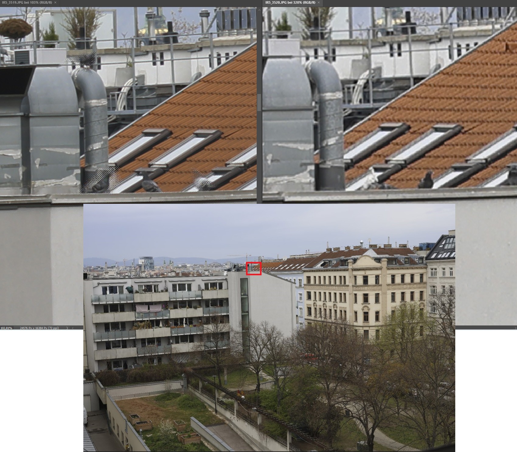

After having installed 1.8.1., I took a few pictures out of my window. What I learned:
- you really need a very sturdy tripod
- you must use a remote trigger, or the 10 second self-timer
- the scene must be absolutely still
- air turbulence will make everything more that 100 feet away look like something created by a mad pointillistic painter
When all the stars align, there really is a lot of additional resolution - but I think that IBIS High Resultion in its current implementation addresses very specific use cases (like interior architecure or reproduction/scanning of scientific artefacts).
(left IBIS HiRes; right normal 45 MP from RAW, ACR with a bit of clarity added)
I used RF 50/1.2 at about 7.1 with manual focusing.
The red rectangle shows the area of the full image that is shown in the two crops.
