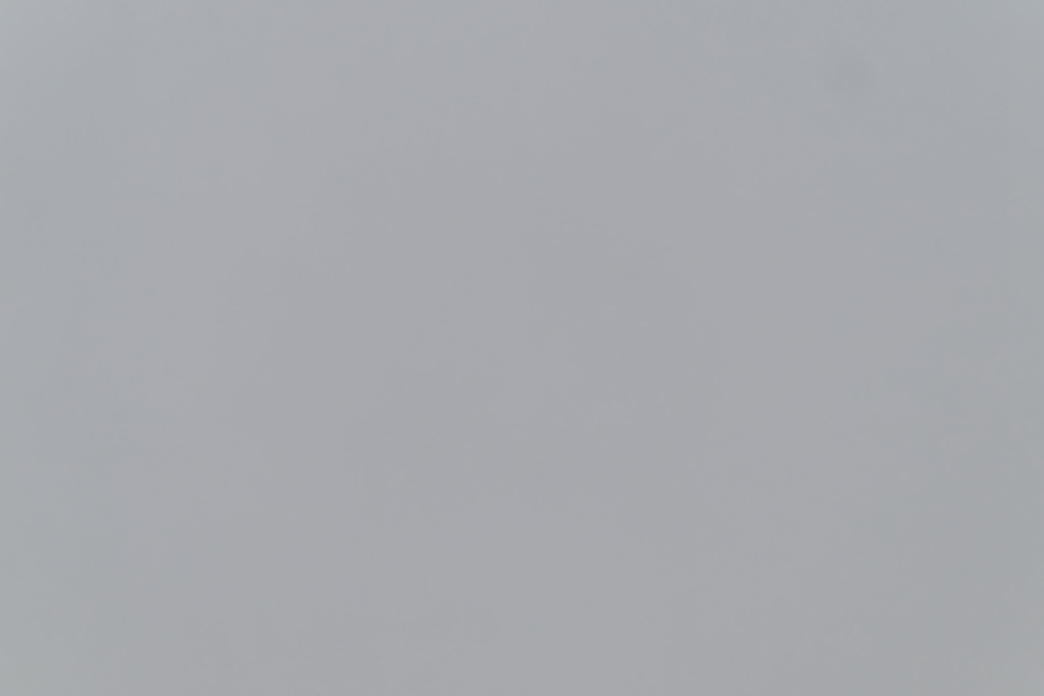

Dirty Z8 Sensor

Not horrible, but the speck is still there. Grrrr. Arrrgh.

Even after taking a swab to it? If it has been there for a bit I know that the heat from the sensor can "bake" in on and it would require a second cleaning.
In Lightroom, set the Dehaze to 100% and post the same photo.

Hi Craig,
1. Tip - remember the dirt on the sensor will be 'upside down' compared to the image (i.e. the dust spec will be at the top of the sensor as you look at it).
2. The LrC 'Dehaze' equivalent in DxO is 'DxO ClearView Plus'.
3. Good luck...

Clean Z8 sensor. Much better!
It took (2) separate swipes with a clean swab to totally eradicate the stubborn spot at the 0600 position, but its gone. Yea for me!
