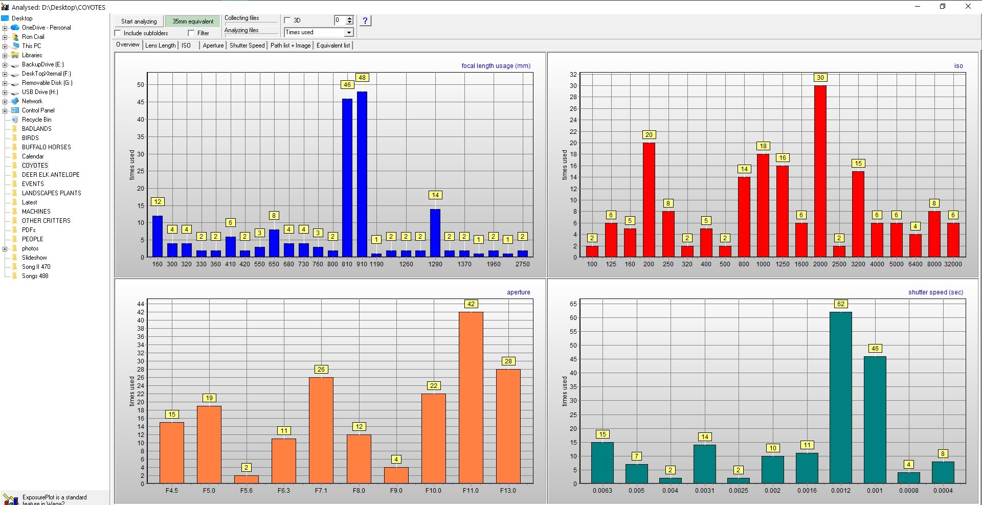

Screen shot from 10+ year old version of exposure plot. I should update it but don't use it that much.

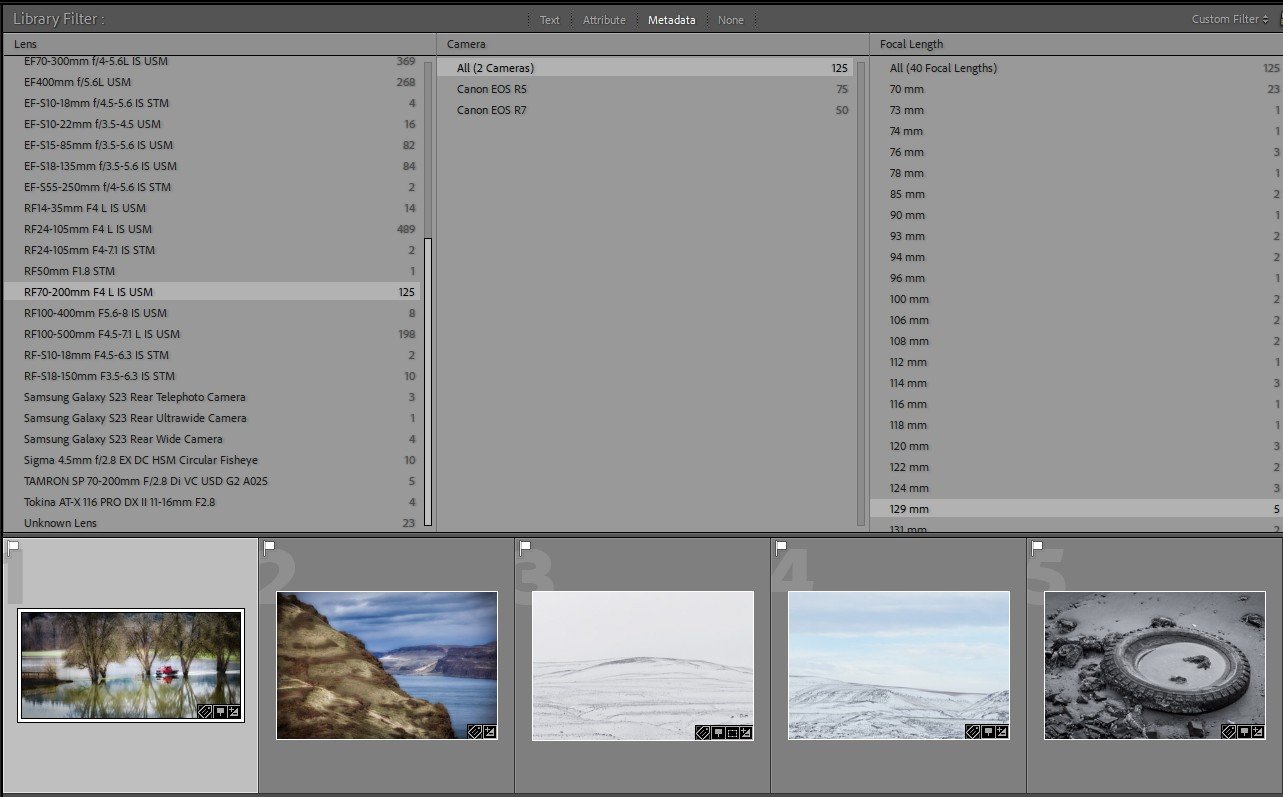

Don't know of such a program. In the past when I wanted some insight on my focal ranges used mostly for an event or from a zoom lens, I did a manual workaround using my lightroom catalog.
With its metadata filters options, there is "lens" and "focal lenght" and behind the options it shows the totals for the values in the selected folder/ collection.
When I'm thinking of what lens to take to an event and doubting between lenses that may overlap or where cropping in on the max end of a lens, I sometimes go to a set of photos from a similar event.
For example with a beach rugby tournament I might want to choose between my 120-300 or 70-200 (which is much more compact). I select a tournament from the past, select my 120-300 lens and then have a look of the totals per focal lenght, for example which percentage was shot over 200mm. I do that by selecting all focal lenghts in the filter that are over 200mm. When I select them all, Lightroom filters and I can see how many photos are selected so I quickly see how many photos were taken over 200mm.

Since the prime focal lenghts usually are 'limited' (24-35-50-85-135-200) it may be more worthwhile to see how many photos with your zoom lens were taken around a prime focal length, for example between 30-40mm to assess if a 35 would be usefull. The exposure plot shown in the post before this, can make that more easy.

A couple of knocks against EP - it looks like it only works on jpegs, and gives the equivalent focal length on cropped pictures.
That may be something in settings, didn't look that hard.

As Jan mentioned, if you have Lightroom and you're just doing a quick and dirty analysis of 1 lens's usage, Lightroom's metadata grid will probably be enough for what you're looking for. If you're only looking at that 1 lens, the RF 70-200/2.8, you only have 131 possible values for focal length; few enough to just eyeball.
I used a metadata list from a collection with 2115 images and 125 of those images were made with my RF 70-200/4. Of those 125 images, 57 (46%) were made at either 70mm (23) or 200mm (34). Everything else was pretty much scattered over the middle of the range. Turns out I had 5 shots made at 129mm, but no other focal length had more than 3 images, and those focal lengths were distributed pretty evenly throughout the lens's range. Only 40 distinct focal lengths have were used in this sample out of the possible 131 available. I bet you'll find similar results with your lens usage as well.
