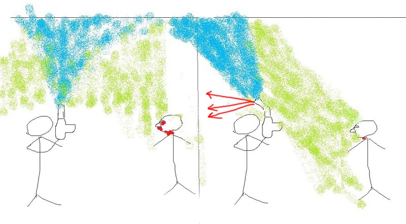

I got this idea from a site many years ago which I call the reverse ceiling bounce. Less shadows under the nose, etc.

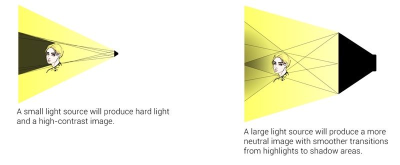

I did some flash workshops many years ago. Getting people to understand hard and soft light sources was a major component. Also light photons travel in strait lines. Bouncing light is like playing pool with light. The sun is many times larger than the earth but because of its distance it looks like the size of a basketball thus a small light source that produces hard light. Like direct flash. On a cloudy day the light is diffused so the light source is much larger. You can see the difference in the shadows under cars on sunny and cloudy days. Bouncing the flash or using an umbrella creates a much larger light source.
