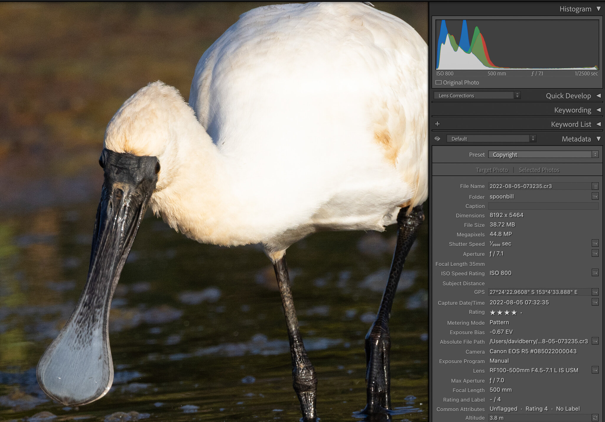

Royal Spoonbill
I hope this image illustrates the problem that Highlight Tone Priority addresses: a black and white bird! How do we preserve detail in the white feathers: I did my best by overriding the R5's auto-ISO but, obviously, I failed!
This is a screenshot from Lightroom Classic—LrC with camera information shown on the right:
  • R5m1 + RF 100–500
  • f/7.1 (maximum aperture)
  • 1/2500 second
  • ISO 800
  • Exposure Compensation - ⅔ (aka exposure value -0.67EV)
Note how I attempted to preserve the highlights by reducing the EV (exposure value) by darkening the entire photo by two-thirds of a stop. This made everything too dark, not just the brightest feathers.
This is where Highlight Tone Priority comes to our rescue. Well, it's supposed to! I tried HTP shortly after taking this photo (August 2022) but gave up in despair. It's time — thanks to prompting by Jan Wegener and our own PF — to try again.
… David

This is the problem that HTP addresses…
I got more out of your explanation than I did his….🤨 When he started in with ETTR, I audibly rolled my eyes.
Seeing your histogram -crammed to the left - and the little spike on the right that correlated to the brightest, whitest parts of your image kind of made it make sense. They’re baking a tone curve in.
I had always heard that HTP, along with Picture Styles and other things only affected JPEGs and the only reason RAW shooters should care about them is that they affect what you’re seeing in the EVF and LCD (and thus using to make judgement calls ).
Of course if they had called it ‘Protect Highlights” or something humans could understand, we might not be having this conversation. 😑

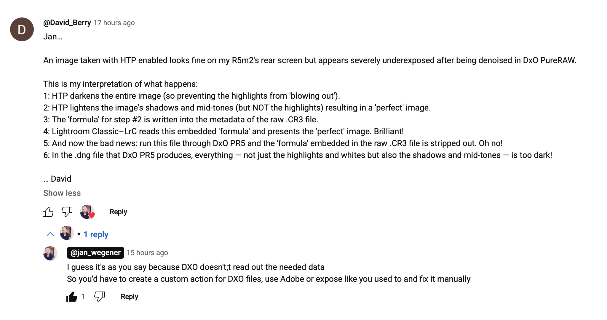

An image taken with HTP enabled looks fine on my R5m2's rear screen but appears severely underexposed after being denoised in DxO PureRAW.
This is my interpretation of what happens:
  1. HTP darkens the entire image (so preventing the highlights from 'blowing out').
  2. HTP lightens the image's shadows and mid-tones (but NOT the highlights) resulting in a 'perfect' image.
  3. The 'formula' for step #2 is written into the metadata of the raw .CR3 file.
  4. Lightroom Classic–LrC reads this embedded 'formula' and presents the 'perfect' image. Brilliant!
  5. And now the bad news: run this file through DxO PR5 and the 'formula' embedded in the raw .CR3 file is stripped out. Oh no!
  6. In the .dng file that DxO PR5 produces, everything — not just the highlights and whites but also the shadows and mid-tones — is too dark!
… David
About that 'guy on the internet' (Jan Wegener in particular) …
The following is a screenshot from comments on Jan's video (link in post #2):
Jan Wegener's Reply
I hugely respect Jan Wegener's views and I have learned a great deal from him.
However, given that I do use DxO PR5, I'll skip Highlight Tone Priority (because every part of every image will be darkened) and rely on calming down the highlights by dialling in some negative exposure compensation (EC)… but only when necessary and not as a standard precaution.
  • HTP = good
  • PR5 = good
  • HTP + PR5 = disaster
… David
