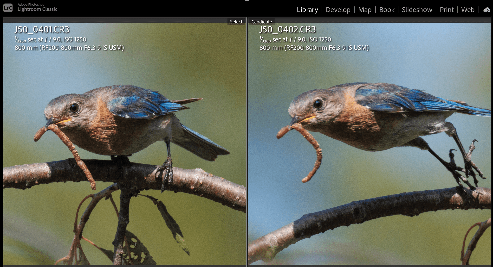

We've got a pair of nesting Bluebirds in the yard and their 3rd clutch is about ready to leave the box and the parents are on constant food delivery, which makes for a great opportunity to shoot - and test the R5II's pre-shot capture as they pause on a nearby tree before diving for the box.
Long post-short, I'm shooting with my 200-800mm at 800mm, wide open. As expected I'm getting great shot as they pose on the branches, and now with the 1/2 second of pre-capture I'm finally getting them leave the branch on the way to the nest. My first shots show that I'm way too slow on the shutter speed so I ramp it up to 1/3200s, then 1/4000, and higher. This shot is from the 1/3200s shots but the results ramping up are the same - the bird off the branch is not sharp.
You can see the branch is still in focus, so the question is am I shooting too slowly (remember, I got up to 1/5000s) or is the lens just not maintaining focus?
That's an open question for you all, but I'm thinking it's the latter, which has me asking a new question - at least to myself. When reading lens reviews I hear things about it being fast or slow focusing, and I've always taken that as the time it takes to obtain focus. But now I'm thinking it also speaks to the speed with which it maintains focus on a moving subject. And with that in mind, I'm starting to wonder if my great new camera body is too much for my current lens(es) (the 200-800mm and 100-500mm)?! If so, am I going to need a "faster" prime to get this?
I'll be testing this again today with the 100-500mm as well, hoping the sun is out so I can ramp up the shutter speeds. But if you have some insight it would be appreciated.

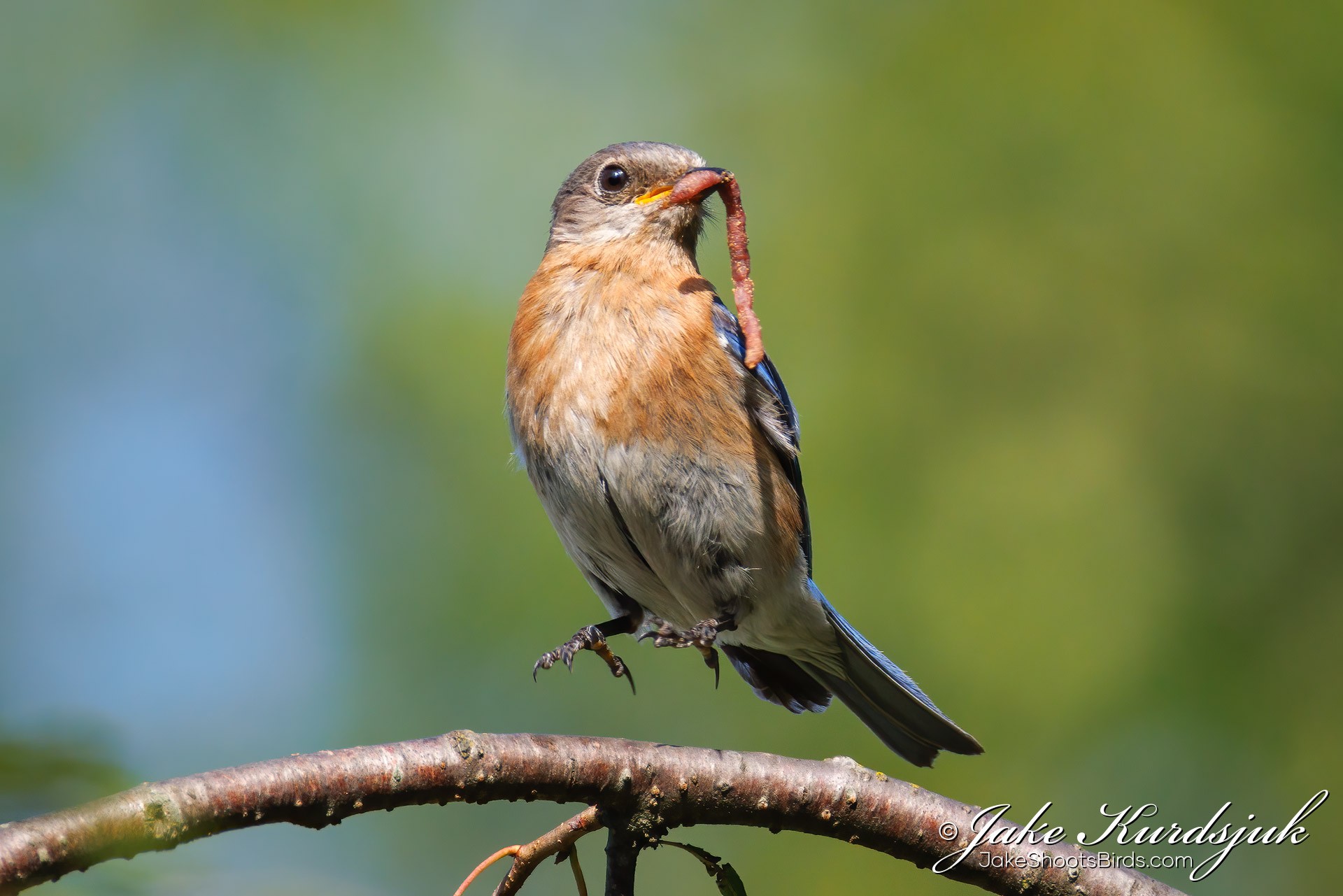

To support my opinion I give you this shot (fully processed) taken a couple seconds before. Here the female went from facing away from me to facing me, and I managed to catch this mid-turn. Granted it's not leaping off a branch, but it's still spinning and 1/3200s was enough to freeze everything. So I'm thinking either my lens doesn't focus fast enough, or I've got something set incorrectly in the camera (which is entirely possible given that I'd only had it for 24 hours).
  • Canon EOS R5m2
  • 800.0 mm
  • ƒ/9
  • 1/1600 sec
  • ISO 640

Considering how well your second picture is focused, I'd guess some reason the first set is back-focusing. I don't know if that's due to body, lens or movement. Might try playing around with the different AF-modes, maybe one of them works better?

Sorry, I don't have pics to support what I'm going to say... Looking at images on my camera, it does appear that per-capture is at a fixed focal length. In more specific terms, while you're holding the half-shutter button, the focus is fixed at the instant of initialization. During the "half-second" of prebuffer, the subject focus is fixes at initialization and does not move until the full shutter press completes the cycle and re-initializes focus actuation.
This is only my current impression, by no means definitive. I only spent 15 minutes using precapture in the back yard and saw the same loss of clarity when the bird changed relative distance. My tests were with a 100-500L.

Moving on... After shooting with the 100-500mm yesterday and having far more success I'm convinced that what I'm seeing is due to a combination of the following:
  • Light makes a huge difference
    • The more light the better it focuses, so faster glass will focus better, and the same glass will focus better in brighter light (duh)
  • Shutter speed combined with focal length makes a huge difference
    • Outside the basic rules for focal length and shutter speed (shoot faster than 1/focal length), what I wasn't considering in the moment is that 1/4000s at 800mm doesn't freeze a 6 inch bird in the frame the same way it does at 500mm because the bird consumes more of the frame. Had I been shooting faster it would have helped, but not solved the issue because...
  • L-series glass makes a huge difference
    • It's going to focus faster. The 200-800mm was maintaining focus but couldn't keep up with the speed of the bird. The 100-500mm kept up with the bird for at least 1/2 second after first movement, which is more than enough considering the size and speed of the bird, and the background I was shooting against.
    • It's going to be faster. The wider the aperture the more light and the faster you can shoot, which is what the first two bullets are all about.
The 200-800mm is a really, really great lens for something that costs less than $2000. But when you're shooting at 800mm and f9 you can only shoot so fast before you max out your ISO when the light isn't perfect (something I was very cognizant of given that I don't have Pure Raw updates for this camera yet). This particular situation would have been fine if I could either shoot faster, or the bird moved slower. If I want to do this at 800mm then I'd have to drop a lot more coin (not happening).
It's weird, but I hear YouTubers saying that they'd love to have less than 1/2 second of pre-capture. But I tell you what, when birds move this fast a half second isn't a lot. LOL
For the short time that I experimented with it yesterday, I need the full 1/2 second, at least. :) I haven't tried lower fps to see if it will go longer than 1/2 second vs always 15 frames, or what happens if I haven't held half-shutter for a 1/2 second before actuating full shutter.
I also saw similar results to the test shots in your original post, leading me to also question the tracking behavior in pre-capture just like you did. It looks like the focus remained on the perch during the pre-capture photos, not tracking the bird. Like I said above, this is nowhere near definitive and my current AF settings may be the reason.
