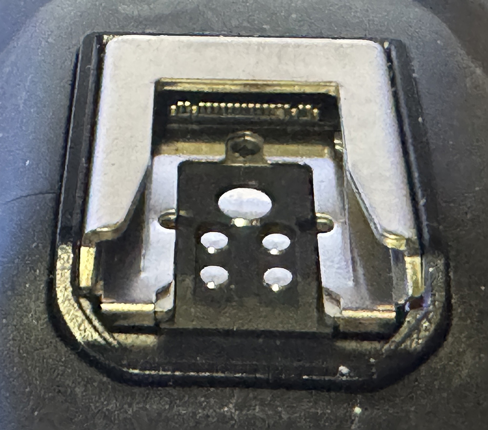

Especially if your flash terminal looks like this (R5m2):
R5m2 flash terminal
I agree with Ed. Godox wireless systems use a different frequency etc. than Canon. So, you have to be either all Godox or all Canon.
I am not sure why you are concerned with the hotshoe design, the EL-5 has the correct hotshoe for the R5 Mk II. You can use it to trigger the 600EX. You could then add lower power Canon flashes if needed for additional fill etc., the 430EX could do this.

If I had your current gear, I would stick with Canon just because of the hotshoe issue. Personally, I am in Godox world and absolutely love it, but if I needed to replace my gear, I might switch to Canon just to avoid having to use the AD-E1.
I tried to use my Godox flash without the AD-E1, but the locking pin on the flash hotshoe isn't in the same position as the hole for the locking pin on the R6 Mark II. The combination without the adapter just didn't feel good to me and therefore I am very happy that I bought the AD-E1. Everything works flawlessly together.
I have the R7 and R6 mkiii and my Godox flashes locking pin line up perfectly! TT 350, TT 685ii and my X3C trigger!
I have to correct what I said above. It is only my Solmeta GMAX-EOS2 which will not work without the AD-E1. Looking back, that was the first hotshoe device which I tried with the new hotshoe on my R6 MkII. It does not lock into place, and I assumed that my other legacy hotshoe flash, Godox V860IIIC would also have the same problem, since they both locked into place perfectly well on my old EOS R. So when I said that I had tried the Godox flash, that was not true, or maybe a failure on my part to make sure it was inserted all the way in.
Your statement made me check everything, my Godox flash works perfectly without the AD-E1. But the GMAX-EOS2 will not. It not only will not lock into place in its normal configuration as well as it will not transmit gps data to the camera via the hotshoe. But when I attach the Solmeta GMAX-EOS2 to the AD-E1, it locks into place with ease and when the AD-E1/GMAX-EOS2 combination is attached to the R6 MkII, everything works perfectly, the gps data is transferred.
The GMAX-EOS2 has a weather sealing gasket to seal around the hotshoe and this is what causes it not to lock the pin in place. When I removed this gasket, the locking pin locked into place as it should, but it still would not deliver data to the camera. So I will have to use the ad-e1 with the GMAX-EOS2.

From what I've researched, the Godox XR TTL and X1R-C TTL Wireless Flash Receivers are not compatible with the EL-5 because of its new multi-function hotshoe. But, the Godox triggers will work on the R5II. If not for the incompatibility with the EL-5, I would probably switch to the Godox system using a couple of the XR TTL receivers on speedlights and a Godox trigger on-camera. I don't normally like my fill-flash on camera. This would be cheaper, more flexible, and allow me still use my older two older 430EX's (not RT). I've successfully used cheap Yongnuo triggers for years, but would like to move away from all the AAA batteries.
