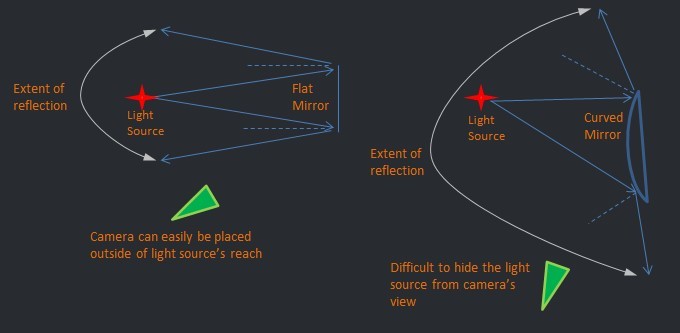

Although a fun analogy, light is more like shooting a trillion tiny billiard balls in all directions rather than one, and the reflections become more problematic once you introduce curved surfaces. As the diagram below visually shows, light will emanate in all directions from a source (red star), and each of the "beams" will get reflected based on the "angle of reflection equal to angle of incidence" from a smooth surface. In the flat mirror's case (on the left) this creates a somewhat narrow field in which the reflection can be seen, but in the case of a curved reflective surface (on the right) such as eyeglasses, human eye, a cup, or a water carafe on the table, the light will bounce in basically all directions off of that surface, and you can't really hide that reflection. With a ring light, the reflection is a very obvious donut which doesn't exist in nature and thus will immediately draw attention. And as Glen also pointed out, since the ring light is right on the lens, you'll always see its reflection in pretty much anything reflective in front of the camera. Better off using a point source, and one covered by a diffuser is even better.
Yup, all very true, thanks for posting that.
I was just trying to explain that in a way that is a way a novice could understand quickly. Can't tell you how many times I used this pool ball analogy over the years to explain lighting to new assistants who were graduates of the best photo schools, but had no idea about lighting. The pool ball was just something basic they seemed to quickly grasp. The fine fineness, that takes a lifetime...

Yes, that is a big part of the issue, glasses and eyes are curved and reflective surfaces. And from an aesthetic point of view, a clearly visible ring light reflection in someone's eye is a beautiful catchlight and to be desired whereas a clearly visible ring light reflection in someone's eyeglasses looks awful.
What would recommend in terms of point source(s) in terms of lighting the eyes?
