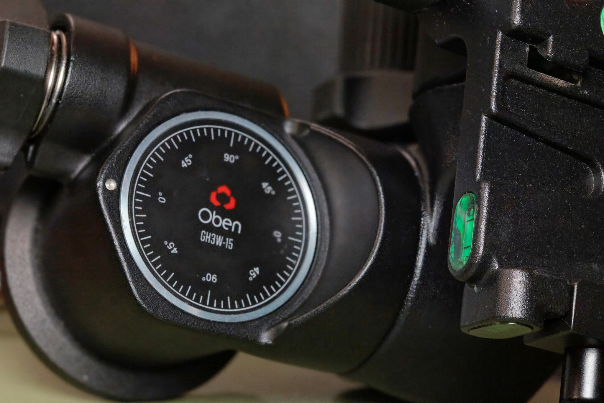

I'm no focus bracket expert, but I have the R5II, Godox TT350, and RF 100mm macro, so I did some indoor testing after reading your post. Can you clarify a few things?
First, when enabling focus bracketing, the camera disables all continuous shooting modes: H+, H, or Low speed. Are you saying these options WERE available earlier in the day?
Second, when you say "interval setting of 4" does that mean the "flash interval" setting in the focus bracketing menu was set to 4 seconds?
And finally, what exposure mode are you using? I use FV and set the shutter speed to match the flash sync speed range. (The manual says the flash sync shutter speed can be 1/8000 with Electronic Shutter and High Speed Sync turned on.)
For the following image, I used number of shots = 10 and flash interval = 0. Although the "continuous shooting" modes are disabled, the shutter still fires as fast as my shutter speed setting allows (e.g. 1/60 is slower than 1/200). Any other flash interval setting delays the shutter between shots by X number of seconds.
