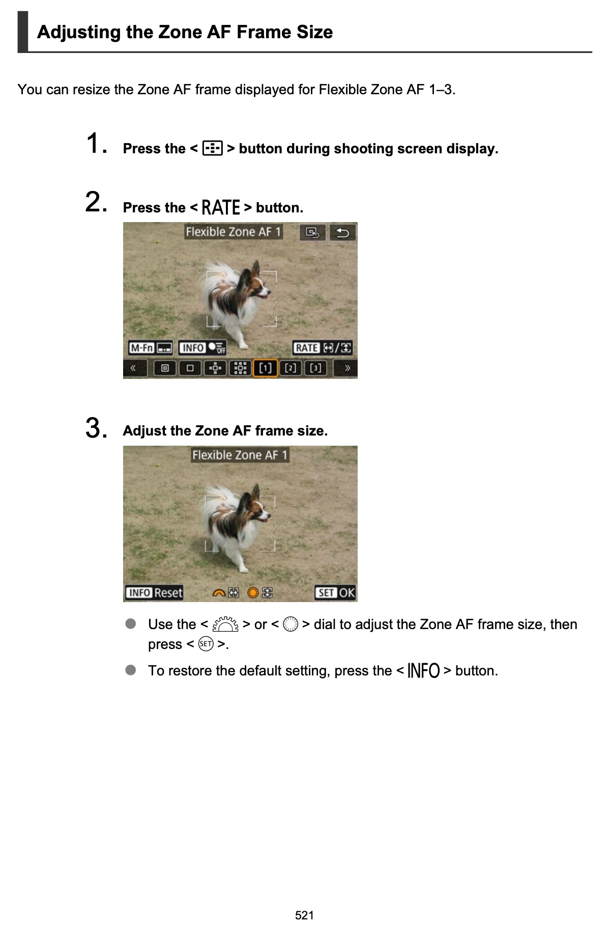

When I choose a flexible zone my EOS R5 mark II, and I press the rate button I cannot modify the flexible zone. I cannot find the answer on the internet Thanks in advance for your kind help.

Hi Harry,
Welcome to the forum!
One of the things I enjoy about researching people's questions is I find out things I didn't know my camera could do. Hence, when I saw your question I thought 'I didn't know you could do that' - and, actually, you can. :)
I tried this on my R5 II using the below guidance - and it works. I'm not sure if I'll use this, but it's something new learned, which is always rewarding.
Well, there you go...

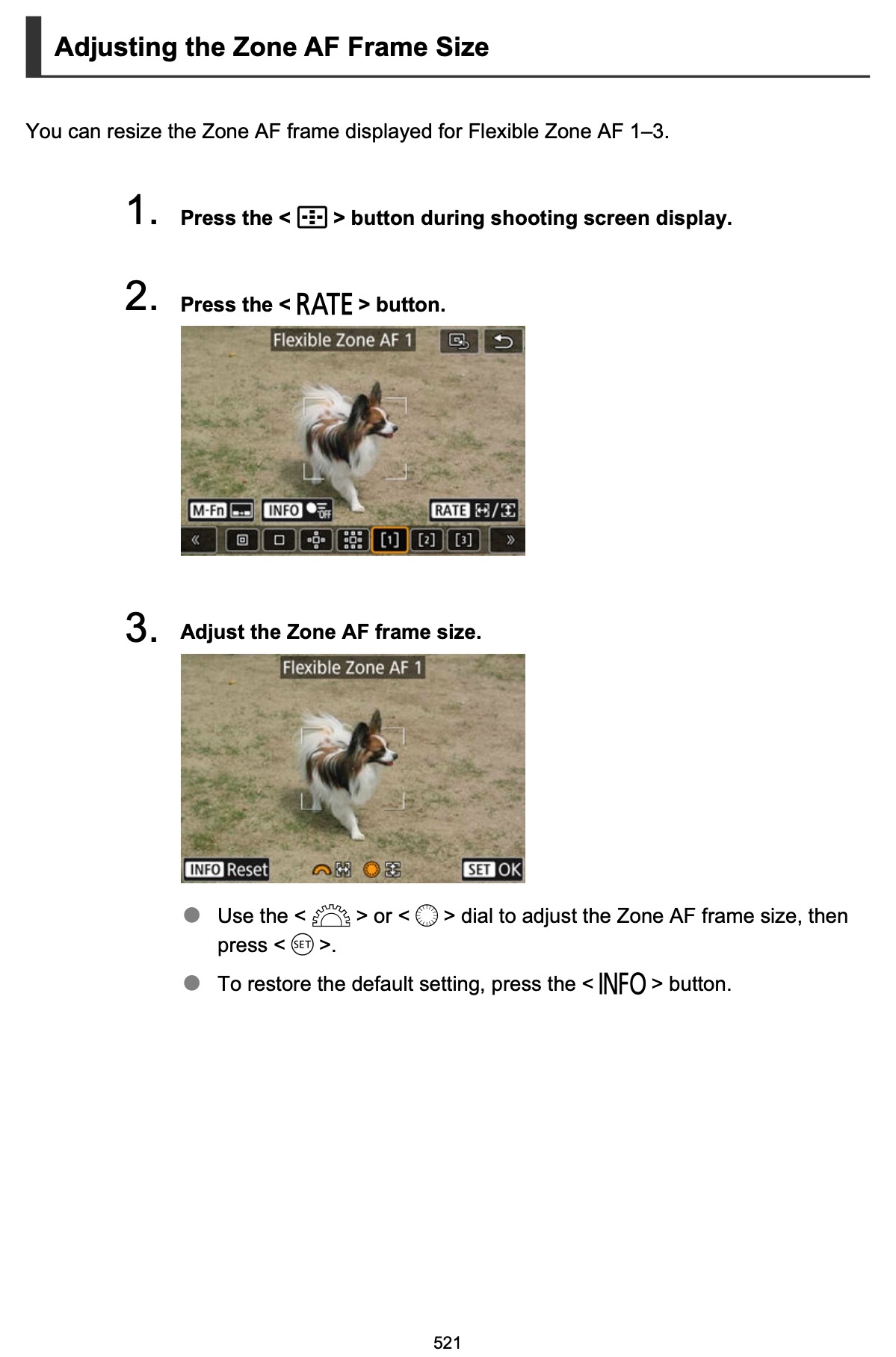

Hi Harry,
Thank you Phil for your answer I have made a mistake. I have assigned one of my buttons to directly change the af-point and therefore I couldn't edit the flexible zone.
Hi Harry,
I'm pleased to hear you got it working.
Many people have done similar things - the R5 II is a very complicated piece of kit - but yours led to me learning something new (there's always a positive!).
