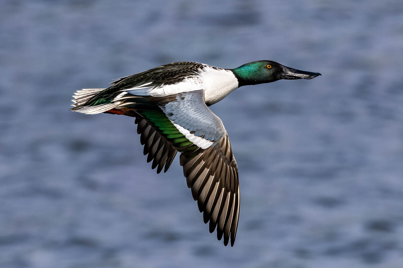

You may get unexpected rolling shutter with ES. I have to point this out to see it. The beak is slightly elongated. You can really see it in the eye.

Yeah, but you can’t really tell. I mean, will people with non-photography minded eyeballs say, “psst, those duck eyes are a taaaad oval for my taste.”

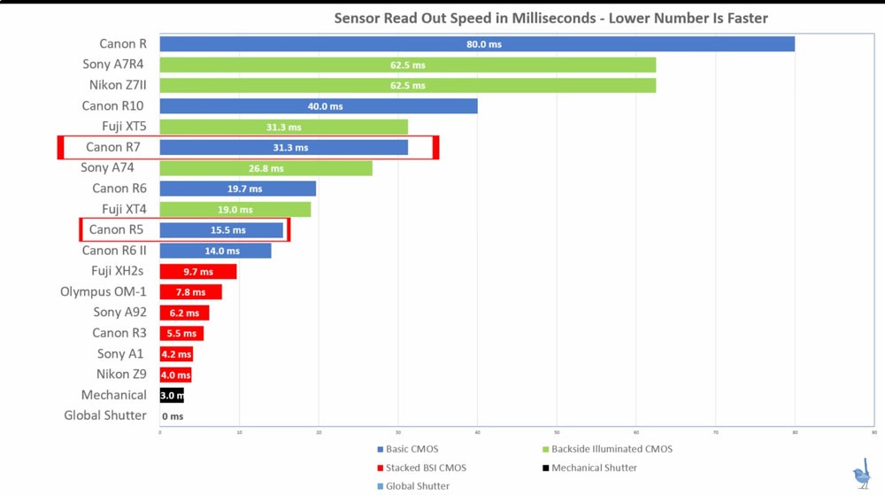

However the readout speed of the R6II is much better than the R7 so it may be negligible. No frame blackout using ES so it will be easier to track those fast jets.
A link for that as well. In the upper left corner you can select milliseconds.
https://horshack-dpreview.github.io/RollingShutter/

Like I said I have to point that out but I know it’s there. Still didn’t stop me from posting it last year. 😀

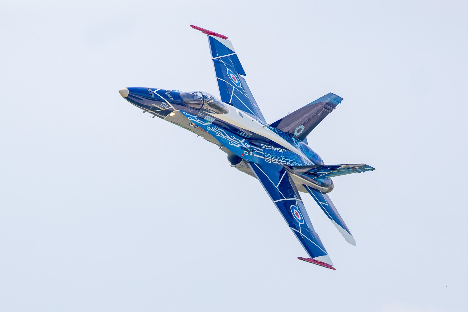

For panning shots with a jet (or anything without its own visible fast moving parts) I don't see how rolling shutter would be a factor. The object is relatively stationary on the sensor. Sure it's changing shape as the angle changes, but not so fast that rolling shutter is likely to be a problem.
Human limbs, bird wings, propellors... those are different because they aren't tracked by the panning. But jets? Convince me!
There may or may not be RS. Yes jets do not have moving wings but you can see the elongated eye in the bird shot. The beak is stretched as well. We don’t know how picky people are. It may bug some and not others.

Just to summarize. You will likely never see rolling shutter as bad as my last post. Just illustrating it is not impossible for it to happen on a subject like a bullet train or fast moving objects. You may see some poles, etc in the background bent over from planes landing and taking off. There may be very slight rolling shutter on the subject.
In that chart I posted the R6II's readout speed is not too bad. Like someone posted I don't have the energy to cull from a 40 fps shoot. Although you can adjust EC fps on the R6II I shoot EFCS at H+ which is plenty for me.

I'm trying to imagine how RSD could affect that image, with no quick-moving parts (relative to the sensor) within the subject. That's all.
I understand how you can make that assessment. It makes sense to me too, but I guess I’ll have to figure it out on site.
