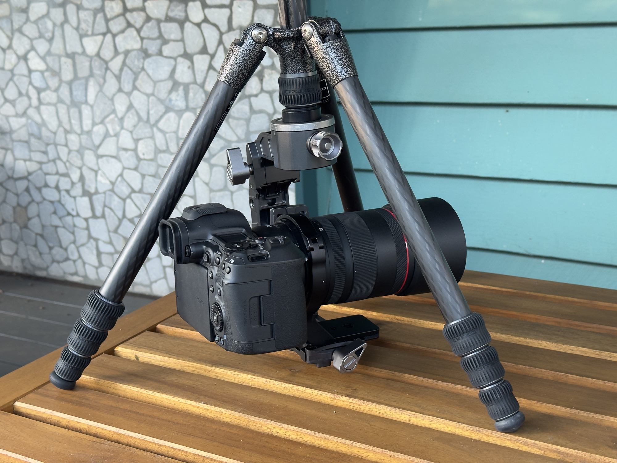

…when I asked about ground level tripods, I was forced to conjure up my own solution:
It’s not perfect - not crazy about “hanging the camera from the hot shoe” and it’s not overly rigid, but it’ll do, for now. I wouldn’t trust it for anything above about 2” off the ground, but that’s not the intended use.
I might make a metal version later on or I might make an Arca Swiss mount that extends out then down, then forks out either side of the lens and then attaches to a plate mounted the “proper” way.

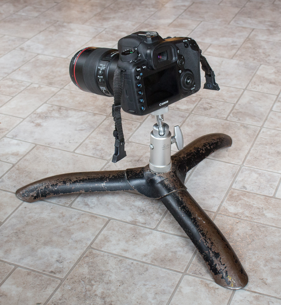

You can make a camera stand out of the base of a music stand.
This places the camera a few inches high. It works great with the subject on a small scissor lift jack.
Of course you can use many different objects in place of the music stand base to support the ball head.

To be serious (it’s difficult these days), I’ll challenge myself to suspend my R5m2 + RF100 macro with no more than 1mm clearance from the aforementioned ‘dirt and mud’…
See above. I can get right down to the ground, if necessary, without touching it. In the photo, it’s sitting on my Arca plate, which I could take off, if I wanted to get the last 3/8” (10mm).

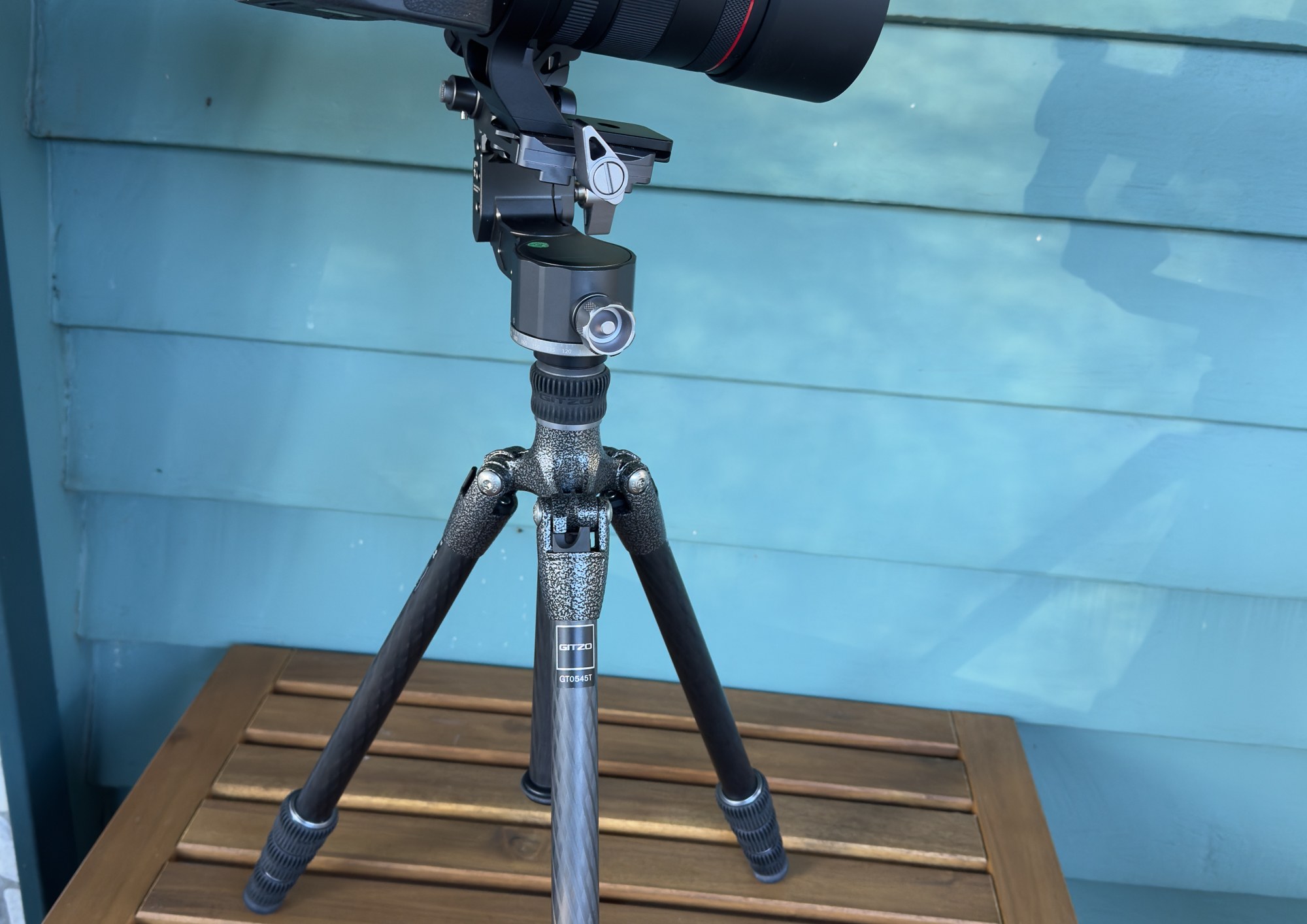

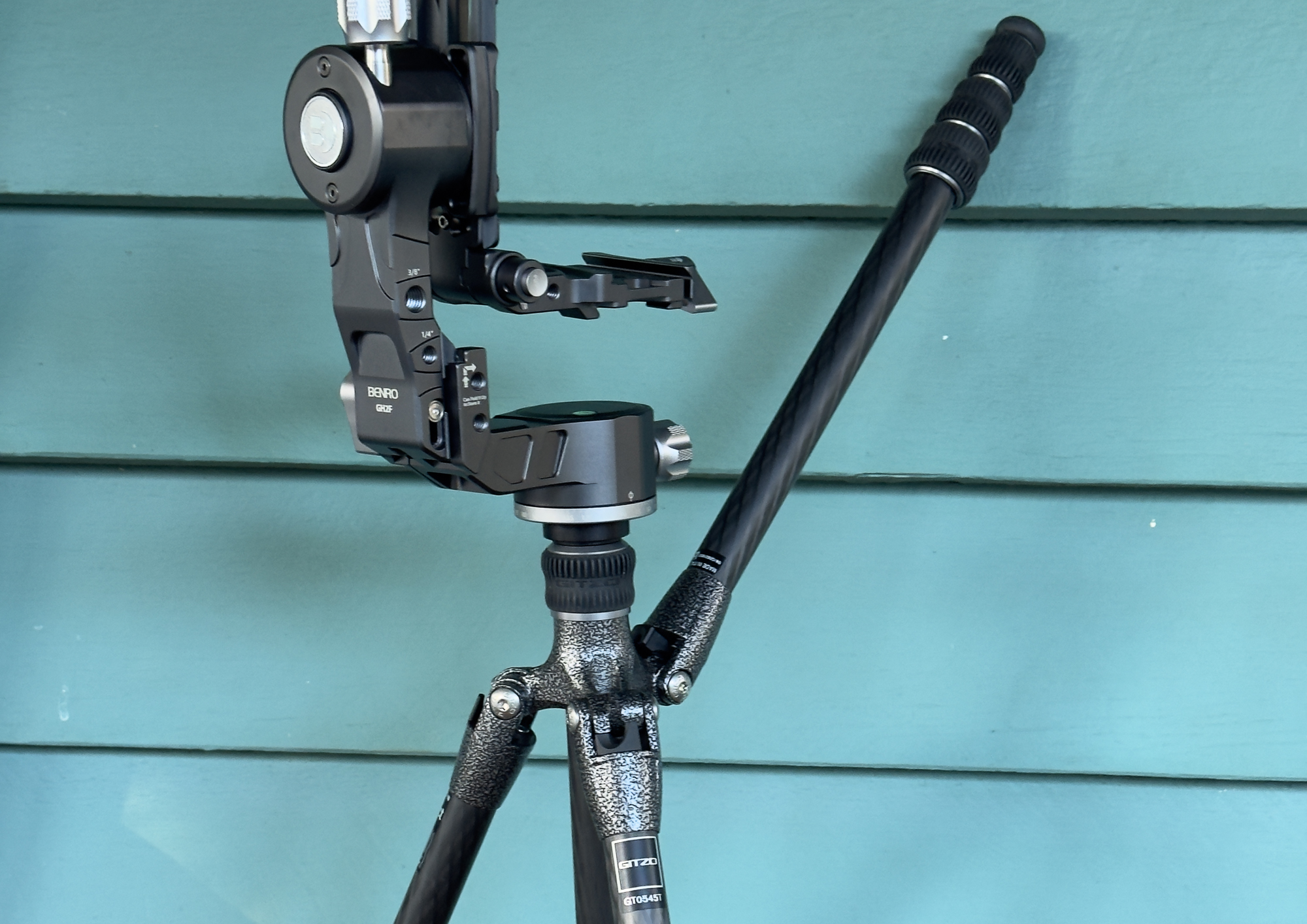

Plan B (following photos) :
  1. DO NOT fiddle with the centre column (leave it in its normal position).
    — photo #1
  2. Swing the legs way beyond their most-splayed position, so that they're pointing upward.
    — photo #2
  3. Invert the entire tripod.
    — photo #3
photo 1
photo 2
photo 3

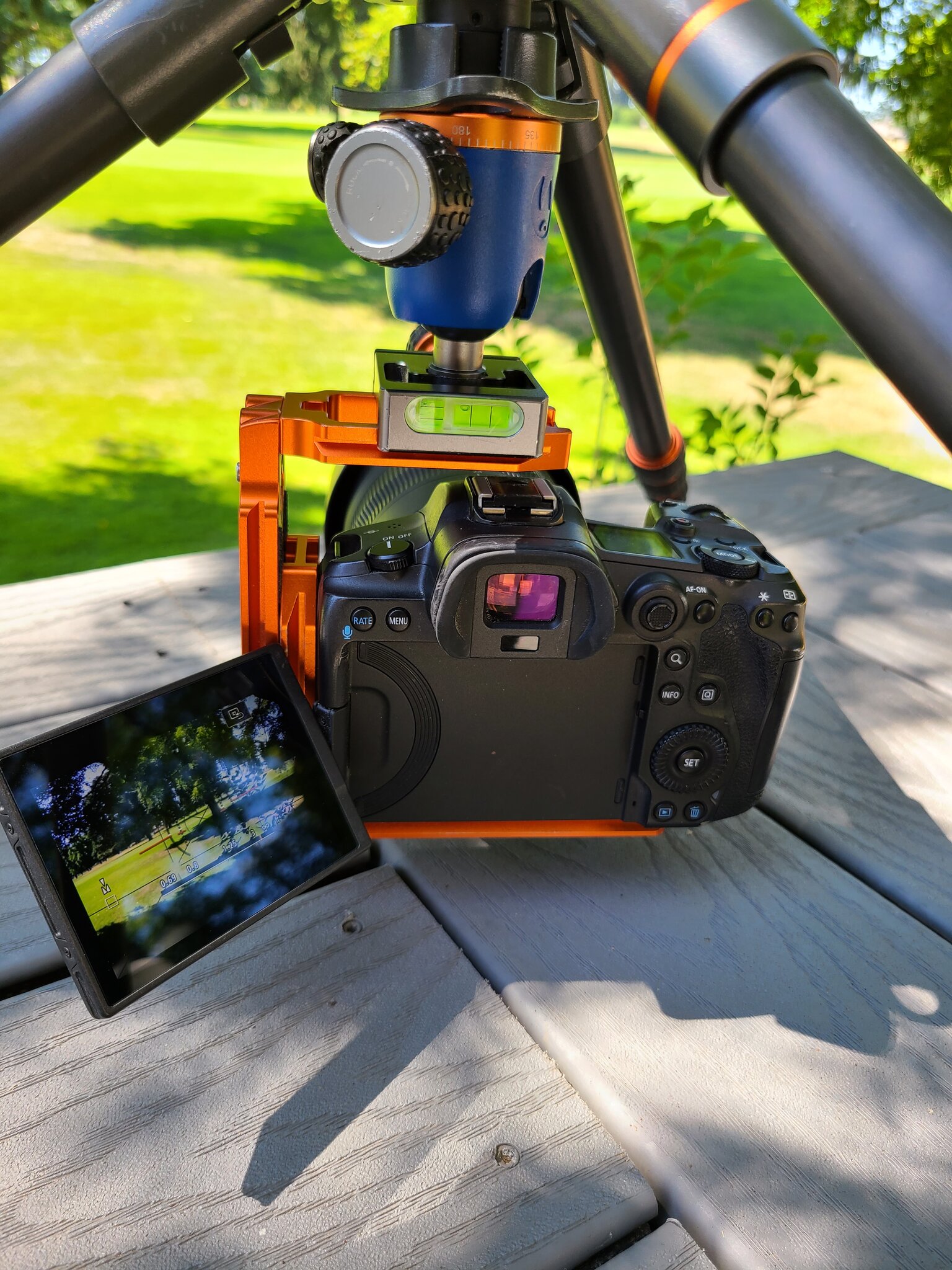

Plan A
(I think this is what is shown in TW's photo in post #1.) :
  1. Set up the tripod normally.
  2. Remove the centre column and insert upside down.
  3. :unsure:
4. Perfect either the art of headstands or learn to work upside down. (Or by an Australian model R5 just for low level shots).
    — photo #1
    — photo #2
    — photo #3

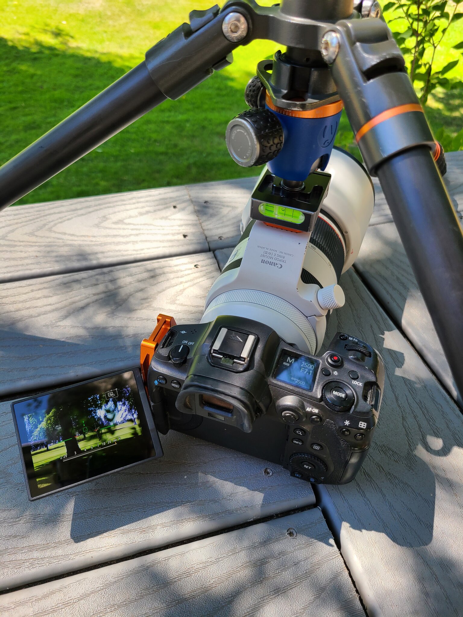

This requires a fancy-ass gimbal head and a lens collar/foot - worth more than my tripod. (And my lens didn’t even come with a lens hood, much less a tripod collar.
…and you’re still not low enough.
Use the lens collar.
Or add the L-Bracket from your other camera body. 😂
What is this lens collar you speak of? Here in non-L land this is only rumor…like lens hoods….
