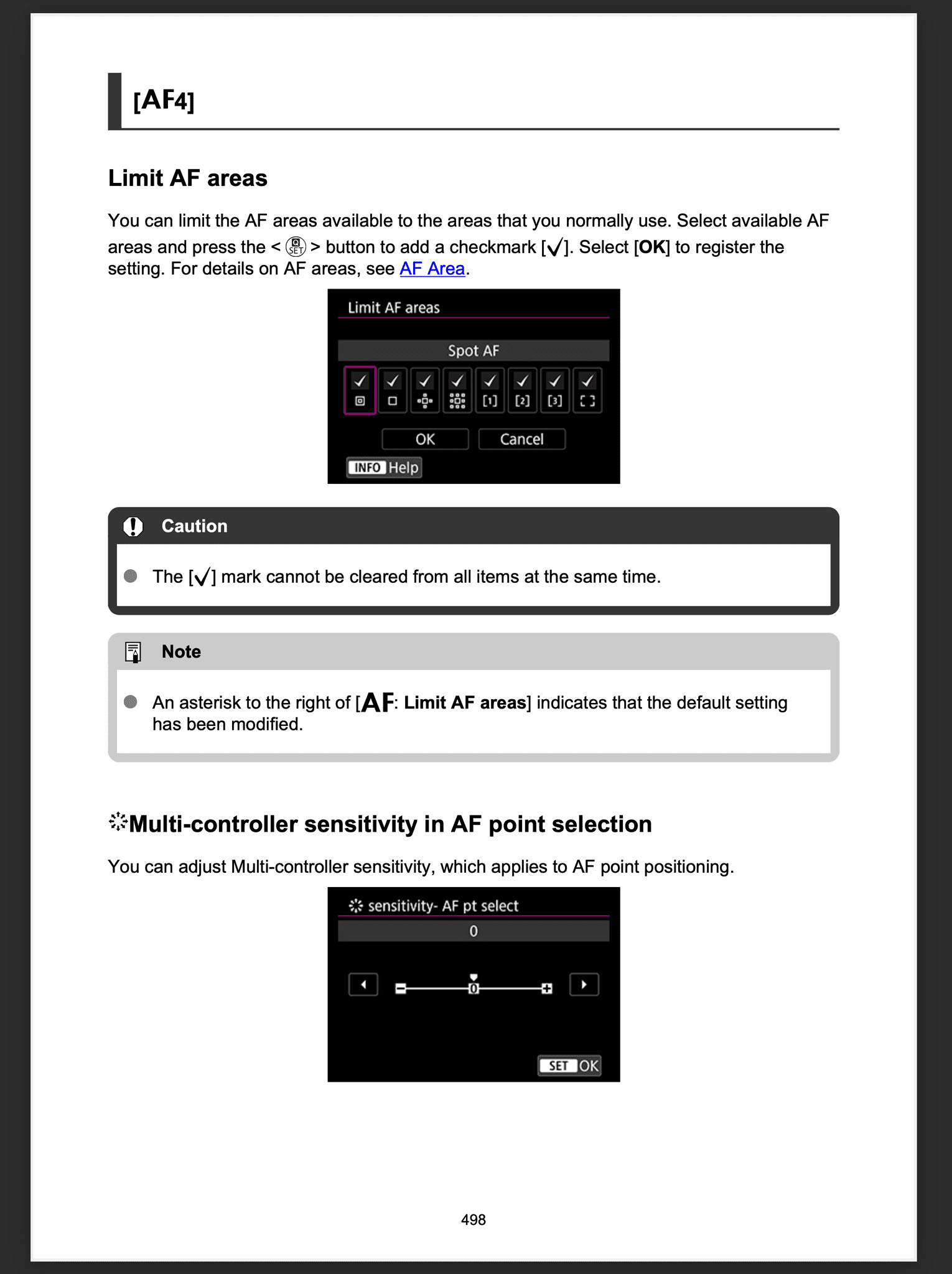

I can't change the focus area in M mode on my r7. It's set to spot focus and when I try to change it, all the options are greyed out. Help.

Hi David,
The first thing I would recommend you check is whether you've limited the choice of AF Areas - refer to Camera Menu [AF] Tab [4].

Thanks, Phil. I had already checked that and it was good, but somewhere else in the byzantine menu system it wasn't good so your suggestion made me go back and find that other place. This camera's AF drives me crazy. Sometimes it's brilliant and sometimes it makes me want to throw the camera in the river.
