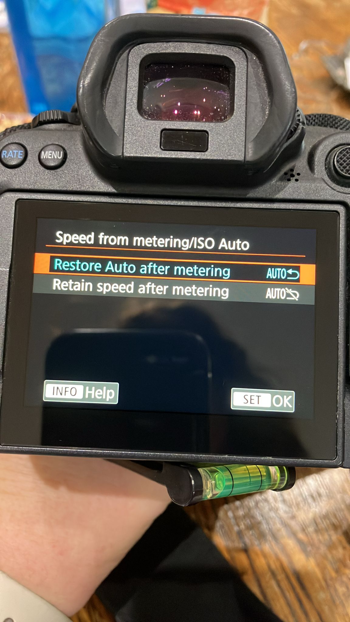

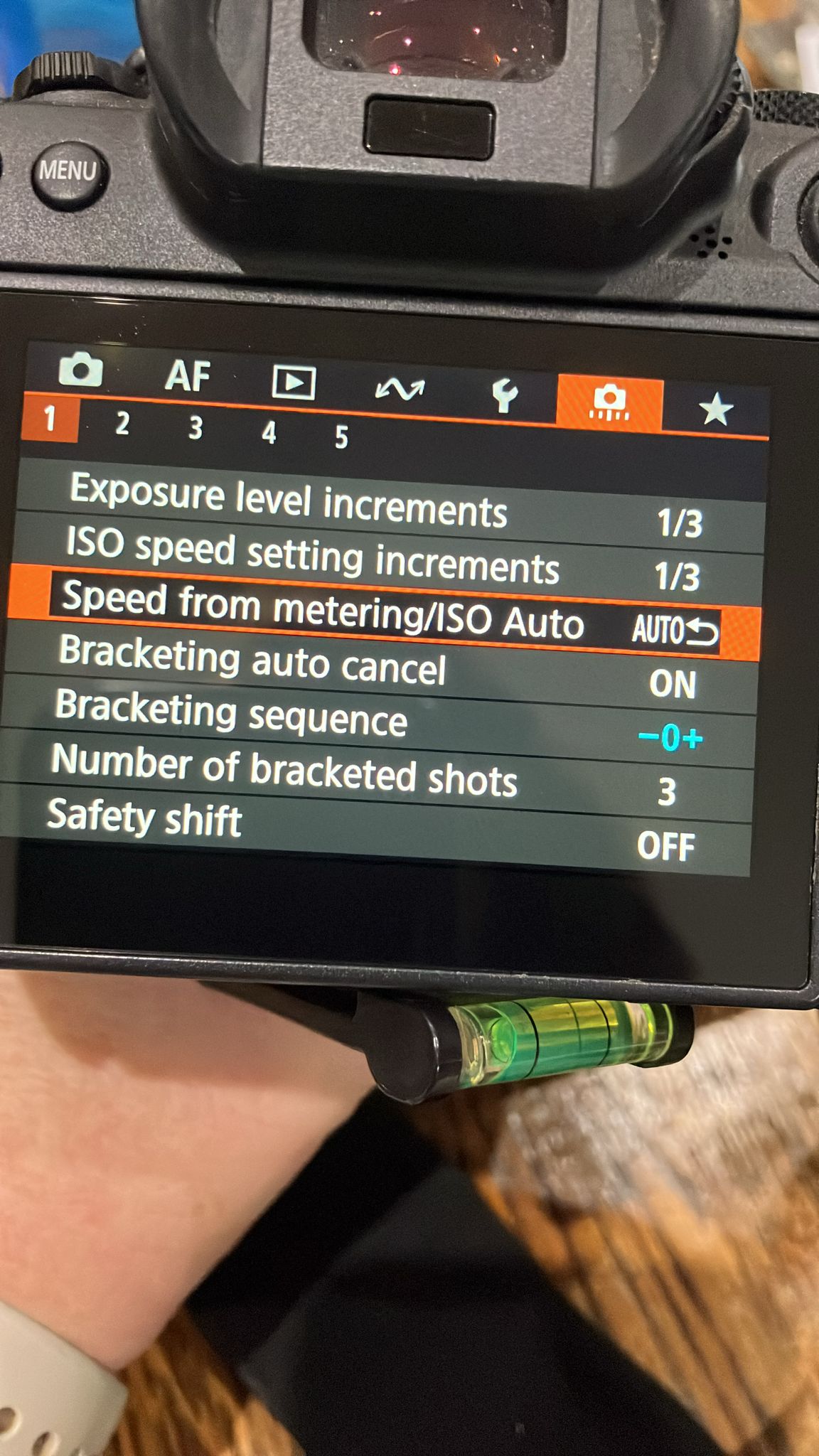

So i had the same issue and found the below was the problem. Ensure ISO is set to Restore Auto after metering. Once you have set this then also ensure that if you are using any of the C1, C2 or C3, that you also update those. This cured the issue for me.
