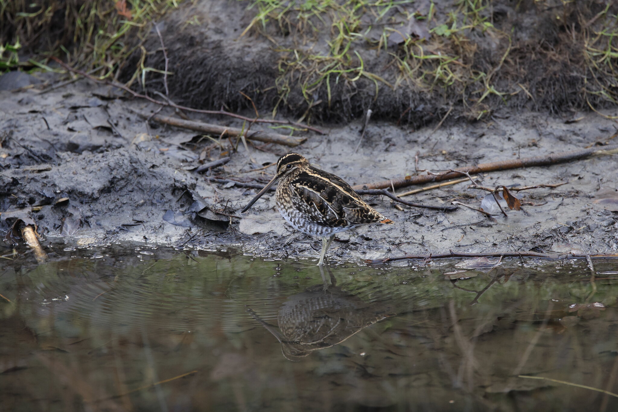

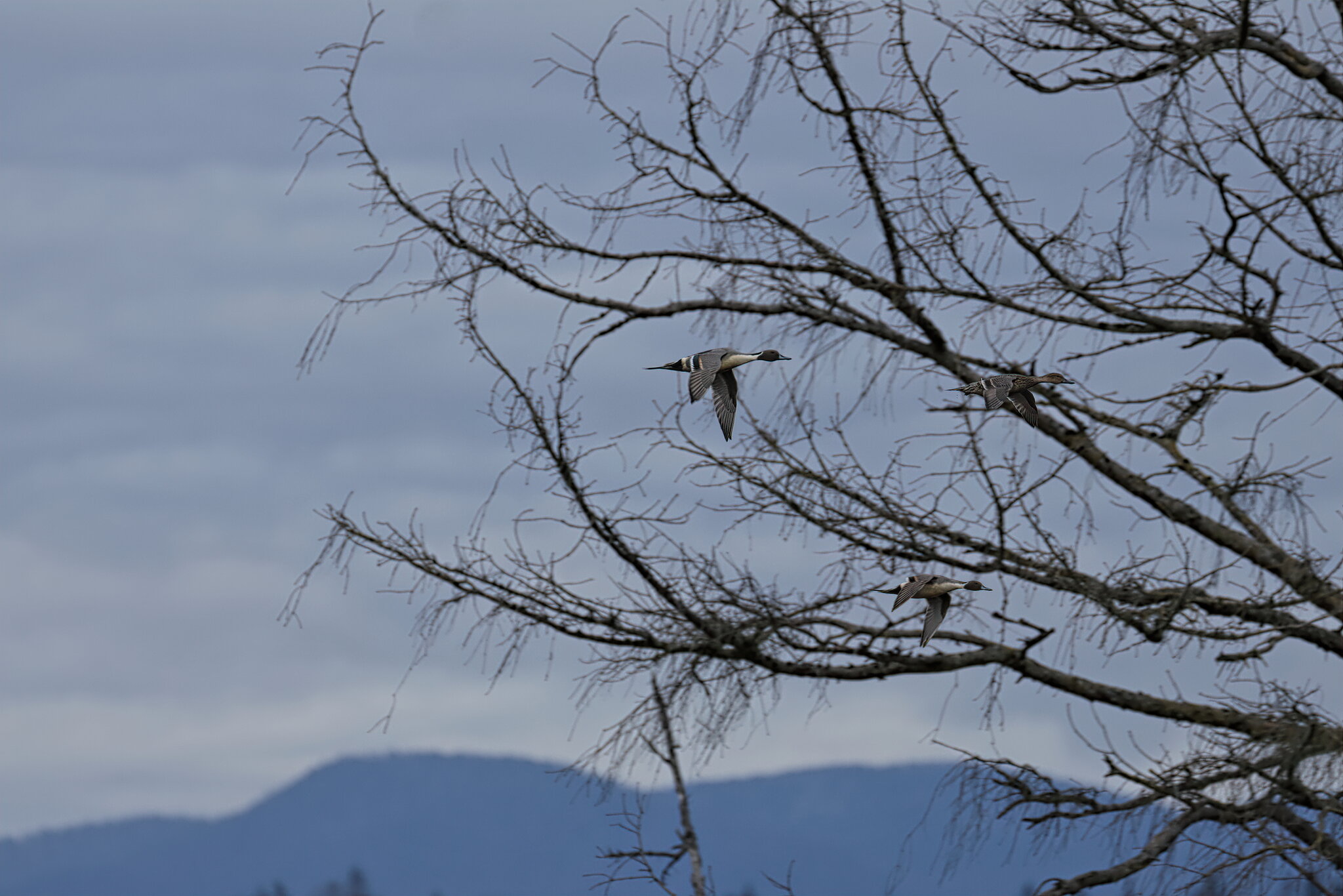

My R7 is set up according to the author of let’s go birding on you tube as per his 30 minute video, he has another video setting up back button focusing . It works well for me however I am satisfied quite easily as an enthusiastic amateur.
