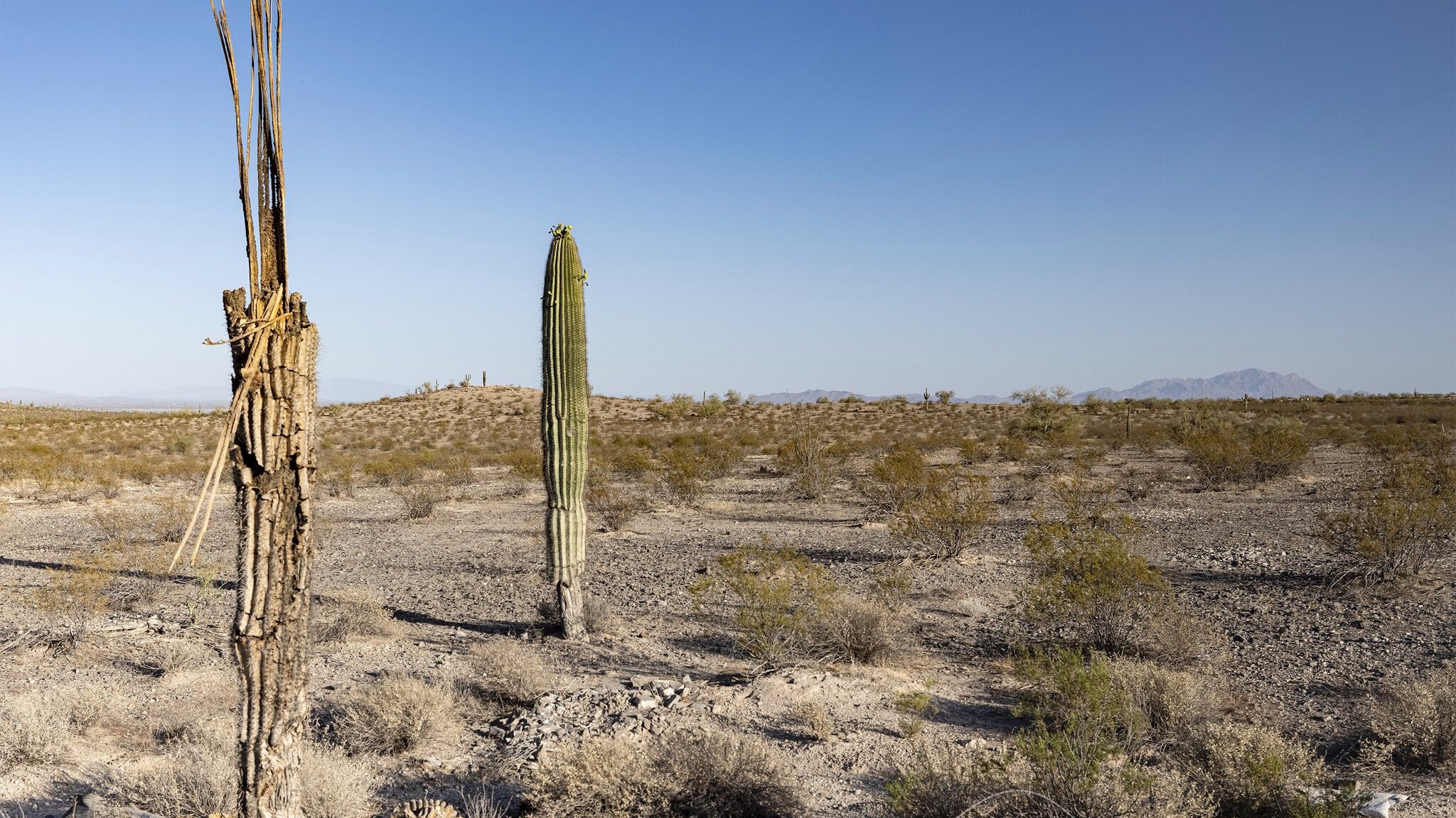

I'm working with a desert landscape mid-afternoon. The subject is obvious and it's pretty sharp all the way through. It just seems flat. R5, RF 15-35, F35, Shutter 1/200, ISO 1000. Not a lot to see in this flat wide-open landscape just thought the two Saguaros one a dead skeleton and one still quite alive were interesting together. Just seems that something is missing.

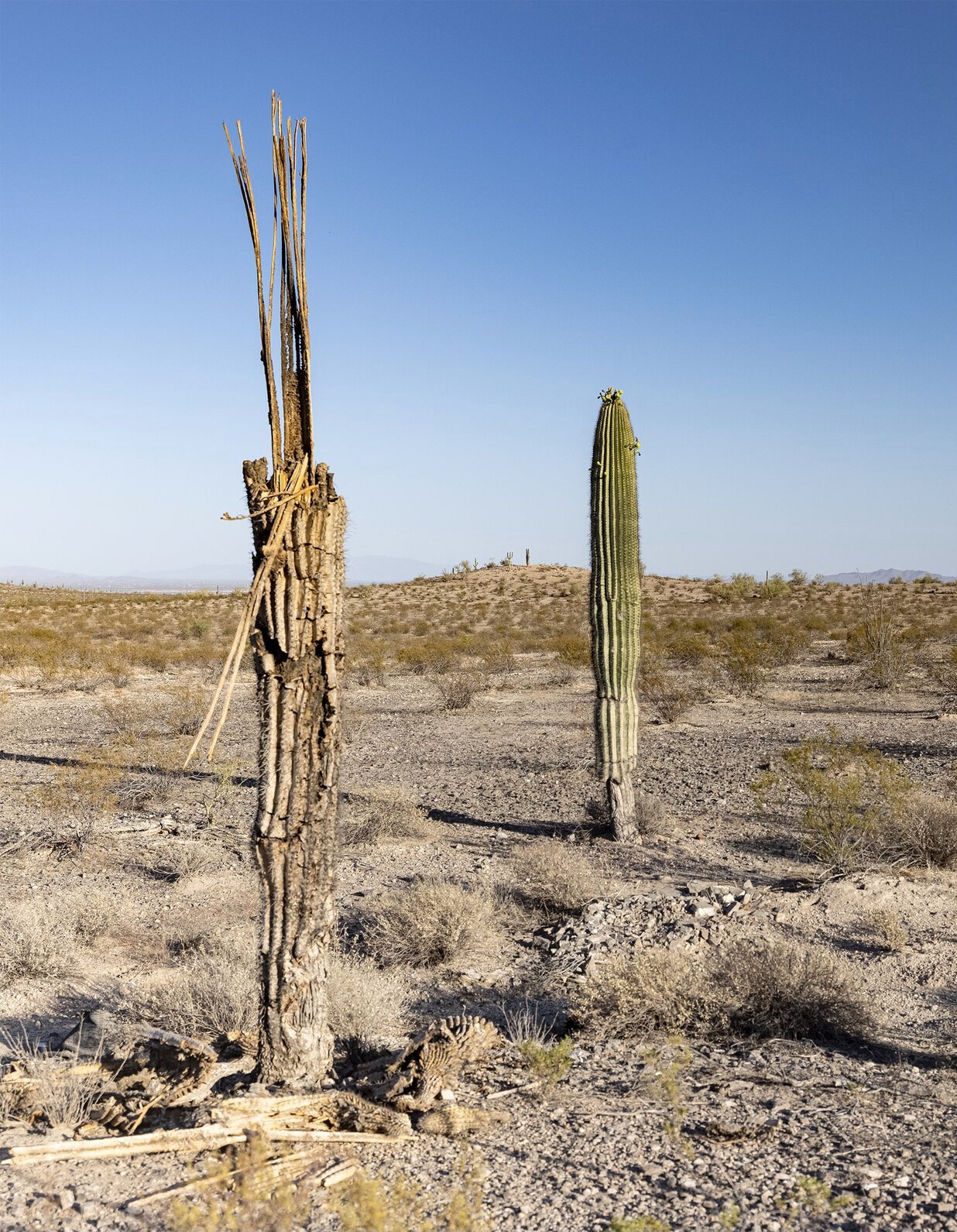

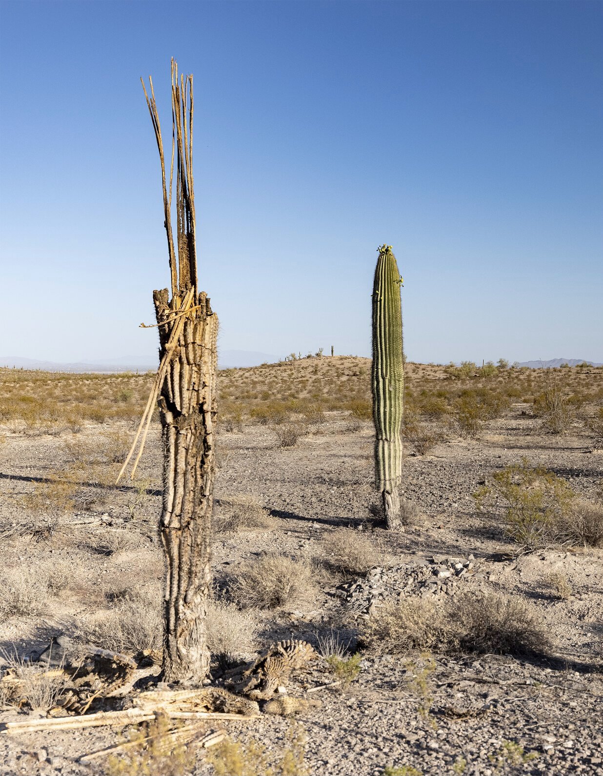

Interesting shot, like the idea. For me the image isn’t balanced with too much empty space to the right. I’m not too sure what the image is about. Is it the desert or plants? I think a similar shot might work if it was one of the plants in isolation. Cropping this one, I would probably go portrait over the plants. There’s still enough desert to put them into context. The other option is a letterbox crop which I think adds a bit of drama to a shot, putting the bigger plant into the foreground. Hope you don’t mind, it’s easier for me to upload the crops rather than describe them, as below.
I don't mind at all. In fact, I chose this image instead of the crop I already have as you have. The empty space on the right side was to show the mountain in the distance but with the 15-35 lens there is absolutely no compression so I think that may be one of the points that fail? I'm finding it hard to compose a landscape in this flat open desert environment. I appreciate your comments and examples.

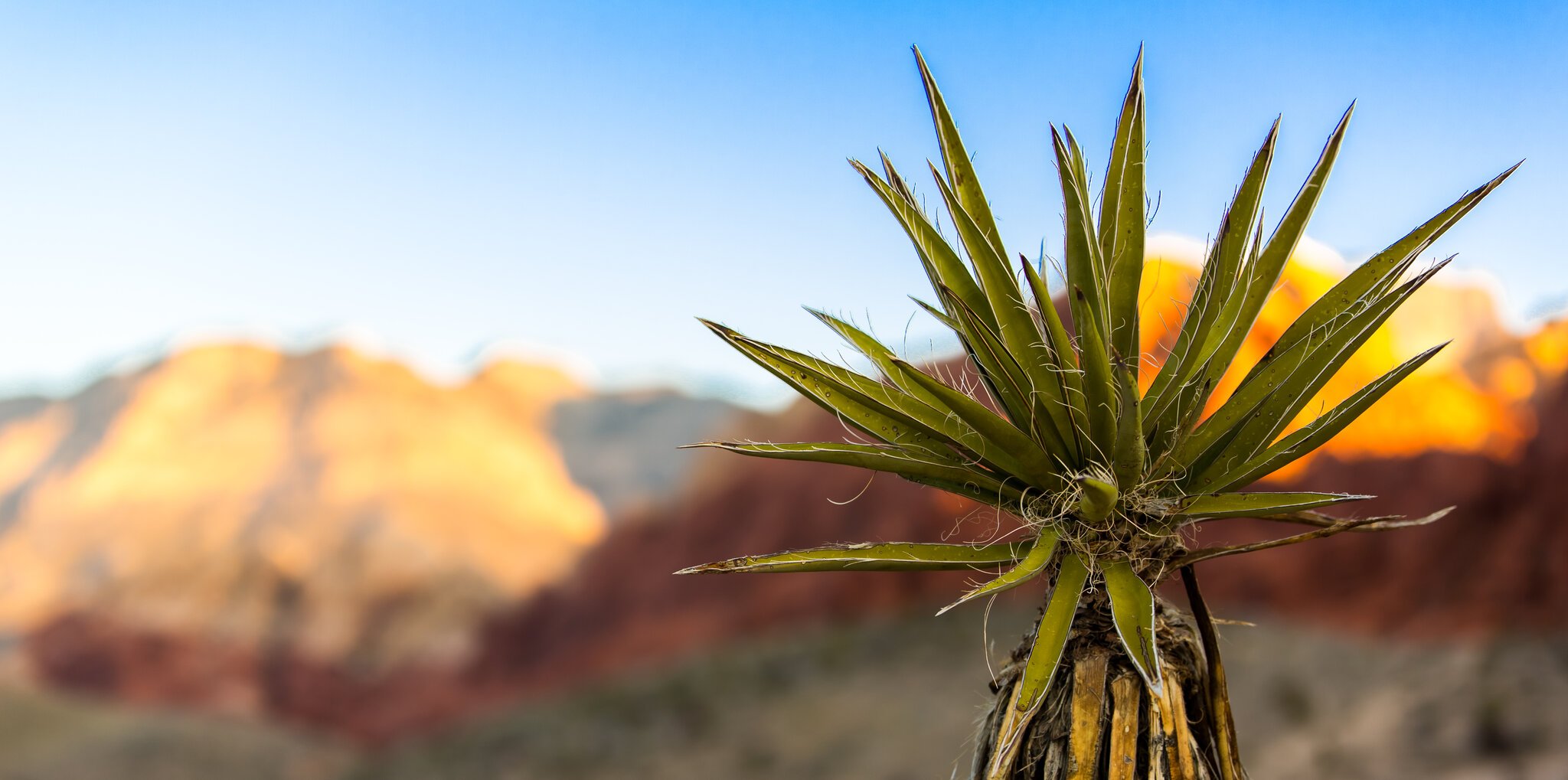

Sorry if I'm adding too much commentary but I was reminded of this image. I took it stopped down and wide open, with everything in focus wasn't memorable but this version with shallow depth of field lent interest. Just like when I shoot macro, I tend to take at least two versions of scene, one wide open and the other at the diffraction point. I love the desert!

Sorry if I'm adding too much commentary but I was reminded of this image. I took it stopped down and wide open, with everything in focus wasn't memorable but this version with shallow depth of field lent interest. Just like when I shoot macro, I tend too take at least two versions of scene, one wide open and the other at the diffraction point. I love the desert!
Don't mind at all. I like this photo. My goal was to take this basic scene and treat it like a basic landscape where the focus is from the foreground to the background. In my case, I'm not sure that there was enough detailed background structure to produce an image like the one above. Also, the top of the Saguaro was a good 10 feet tall or more making this type of shot difficult but it does suggest some other option that I may try again. Thanks.
