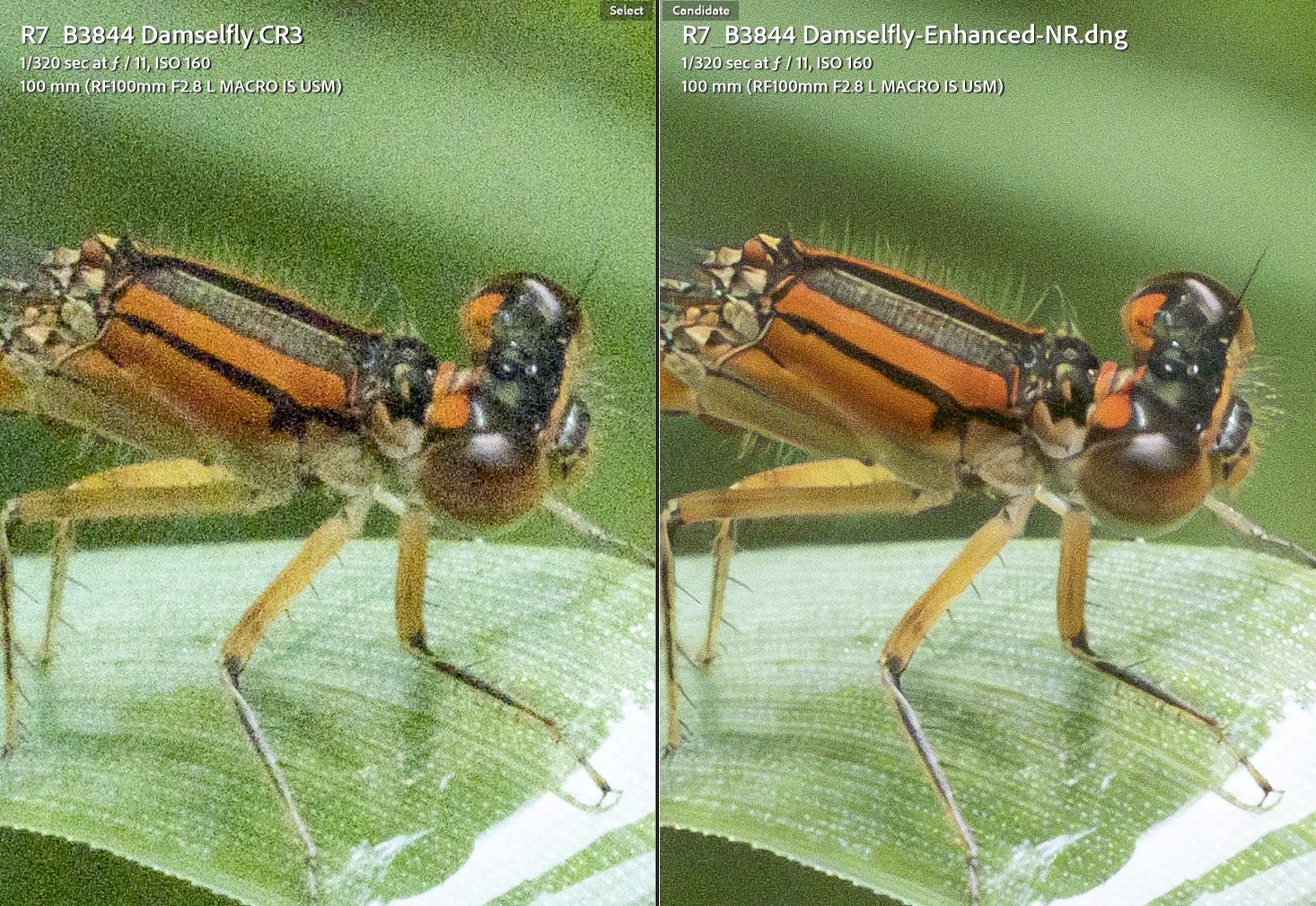

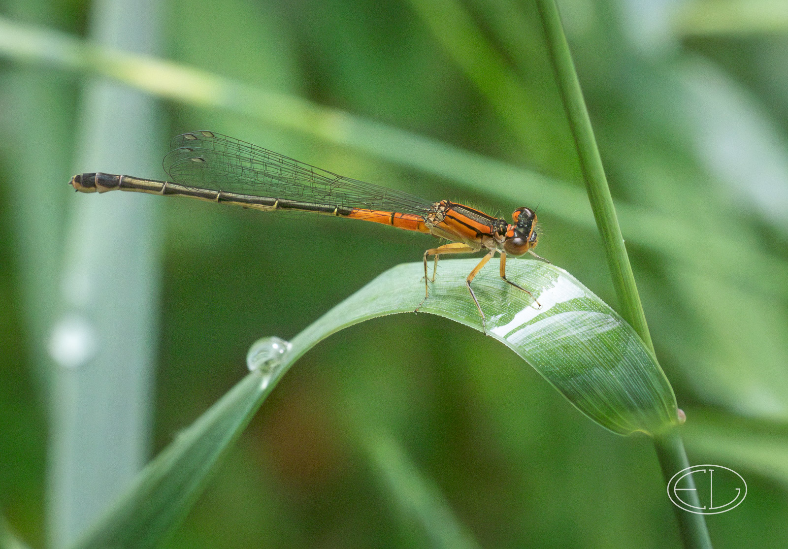

Did you not post a file at another site when Adobe Denoise AI came out? I remember a shot of a dragonfly where the flash didn't go off, the file was very dark and you recovered it?
Yep, good memory. It was 2 years ago. The flash failed and the pic looked almost entirely black. Instead of deleting it, I boosted the exposure by 5 stops. Then I denoised it using Adobe NR.
Here is the final result.
