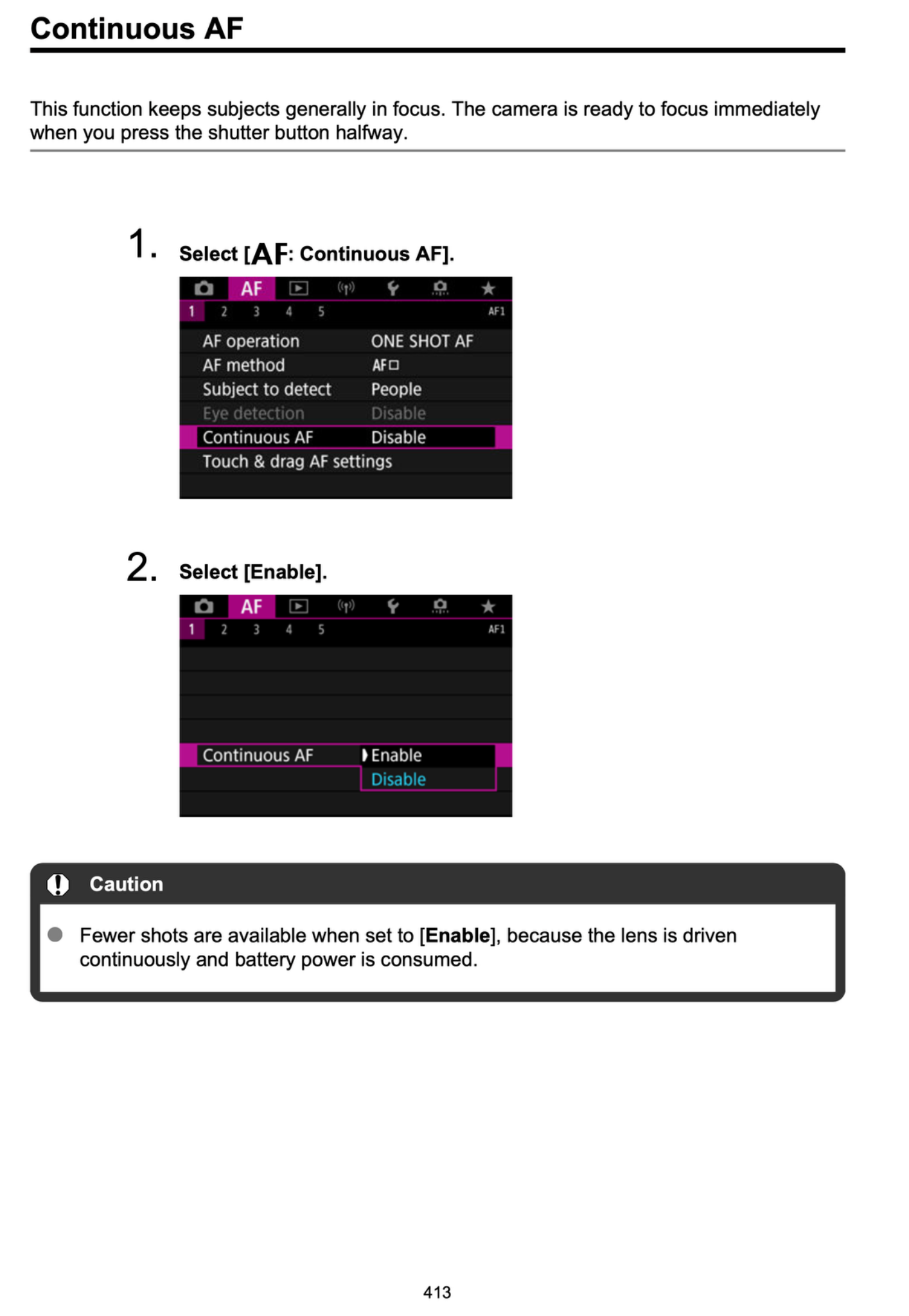

Otherwise, although you say it isn't focus hunting, my first thought regarding 'unusual noise' would be 'Continuous AF'. I believe this feature is enabled by default - but it's a real battery drain so I always disable it. If it's enabled try disabling it to see if that makes a difference.

Hi, Thanks for your response. I do have continuous AF off and notice when i turn off IS it turns itself back on in camera. When i turn the IS off on the lens the noise goes so now suspect lens issue. Many thanks for your help. Cheers
