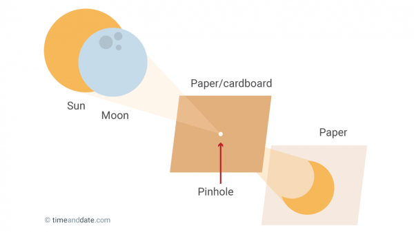

The pinhole method is commonly a pinhole in a sheet a dark paper and a few feet away a sheet of white paper for the rays of sunlight yo land on.

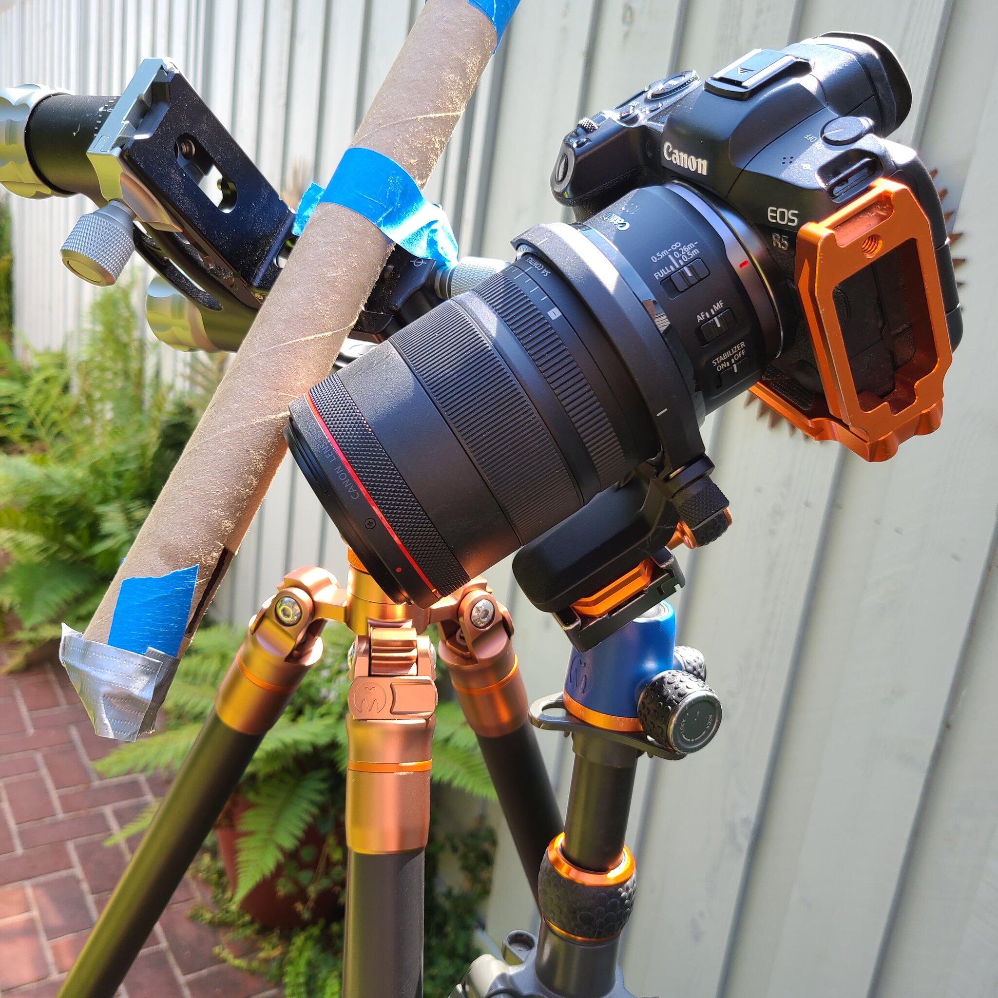

Because I couldn't hold the two papers as well as the camera and manually focusing all at the same time... I had to get creative.

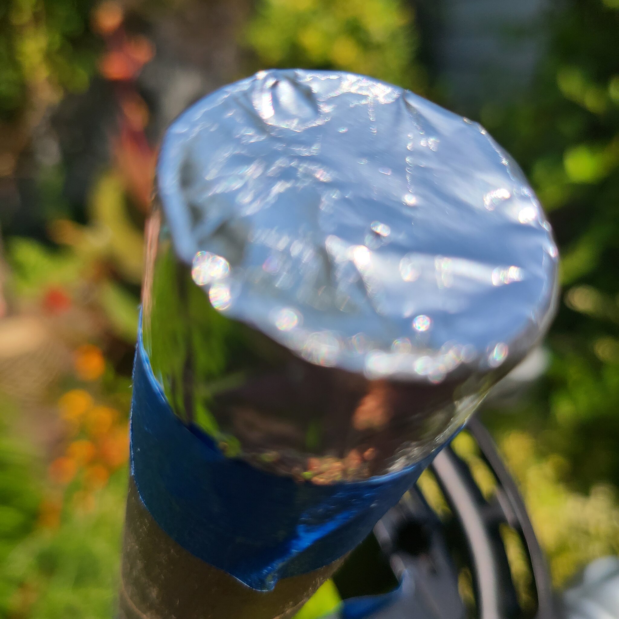

Cover one end of the cardboard tube with aluminum foil and tape into place. Using a straight pin poke a tiny hole in the center of the aluminum foil. Cover the other end with white cardstock and tape into place.

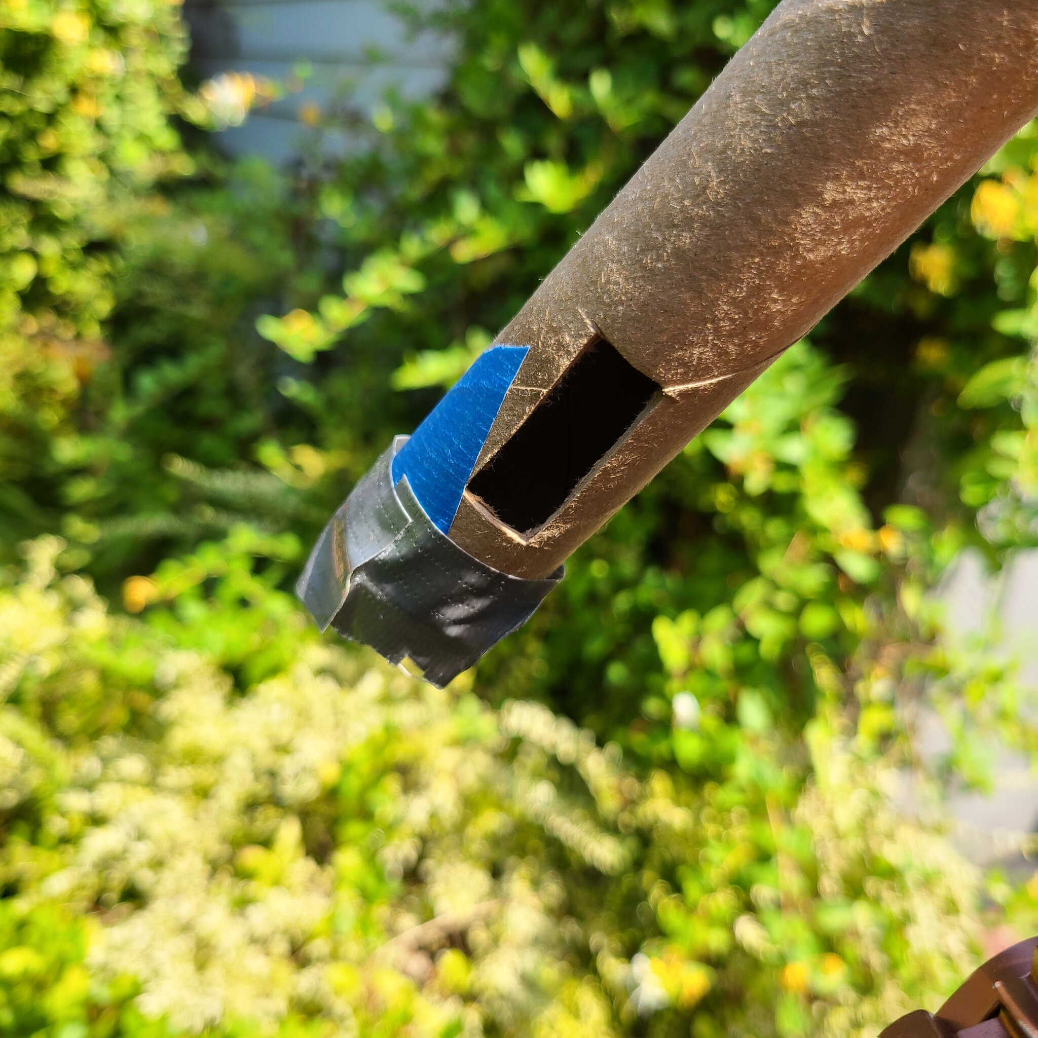

Cut a rectangle hole (horizontal to the long axis of the tube) a couple inches from the white end of the tube. This will be the viewing port.
Place on a tripod and aim it towards the Sun. This is easier than it sounds. Watch the shadow of the tube on the ground and move until the shadow in the smallest. (same method as if using a telescope)
TOP: tiny hole in the aluminum foil towards the Sun.
Bottom: Showing the viewing port.
Setup: Aim the camera to the image of the Sun and attempt to focus.
Take the picture
