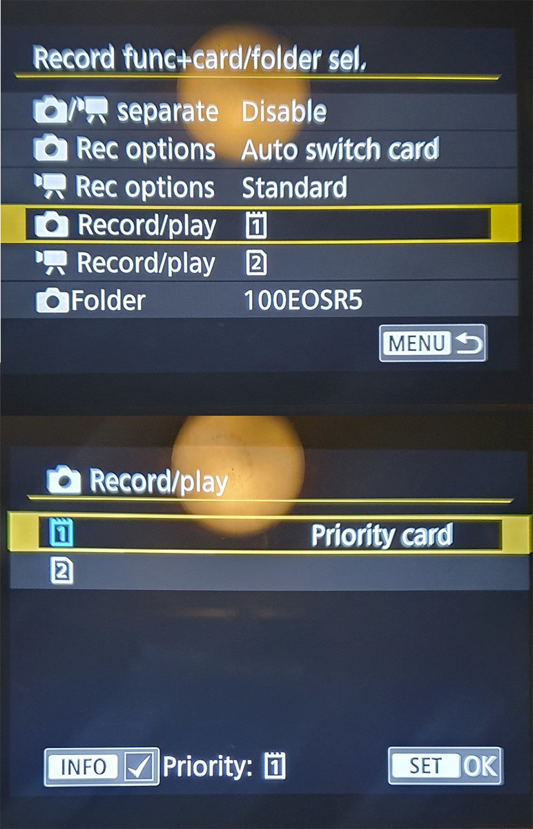

I have it working on both my R5 as my R5ii. Since this topic was about the R5ii according to the tag, I just checked my R5ii.
Took 2 photos to the CF card, switched the camera off, removed the CF card from the camera, took 2 photos to the SD-card (only card in the camera at that moment), switched off the camera, reinserted my CF card, switched the camera on and camera was set to record to the CF-card and took 2 photos that were written to the CF card.
In the attached image my settings for my R5ii, but the R5 had is similar. In the yellow menu page 1/6 I have set recording to "Auto switch card". Under "Record/play" with the photo camera icon I have set CF-card (symbol for CF card with a "1" inside it. When I select that line, the "Record/play" option screens comes forward. If I hit the "Info" button I can toggle on and off the priority for the CF-card 1.
With the Priority option checked, my camera starts recording to the CF-card as soon as there is one in my camera.
Since I changed the setting, I have never shot the CF-card until its full, but I assume once the CF-card is full, the camera will record to the SD-card.

Thanks, but I got my knowledge somewhere on another forum. I noticed card 2 could not be set as the priority, which seems a bit odd, but didn't mind as I wanted card 1 to be my priority.

Holy hell! It works! I've been scouring the bowels of the internet for about two years and this is the first I've seen this.
I kept missing the damned check box

Wow, thanks, seems not just me having this issue, i too completely missed the priority option. Now set up on my R5 Mkii, just tested and goes to card 1 all the time as i wanted it too, Jan if we ever meet, remind me i owe you a drink (or two)
I noticed that the Priority setting is retained when going into the Custom Functions.
