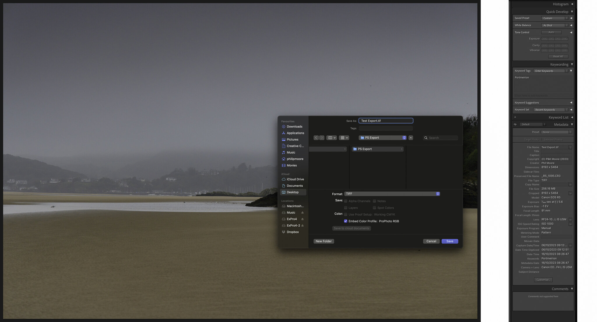

How odd. I've just sent a *.CR3 file across to PS from LrC and then exported/ imported it straight back as a TIFF (no edits). The exif is there.
I also imported the same file direct into PS and then exported it as a TIFF. Opening the TIFF in LrC the exif was as shown in the first example.
I've also imported a *.DNG file (exported from PhotoLab Elite) into PS, exported that as a TIFF and imported that into LrC - exif data still there.
I can't explain why the exif data is getting stripped out in your workflow.
(My system: MacBook Pro M1 Max, macOS Sonoma 14.0, LrC 13.0, Camera Raw 16.0, PS 25.0.0).
Left - Export of TIFF from PS/ Right - Metadata info from the exported TIFF in LrC...
