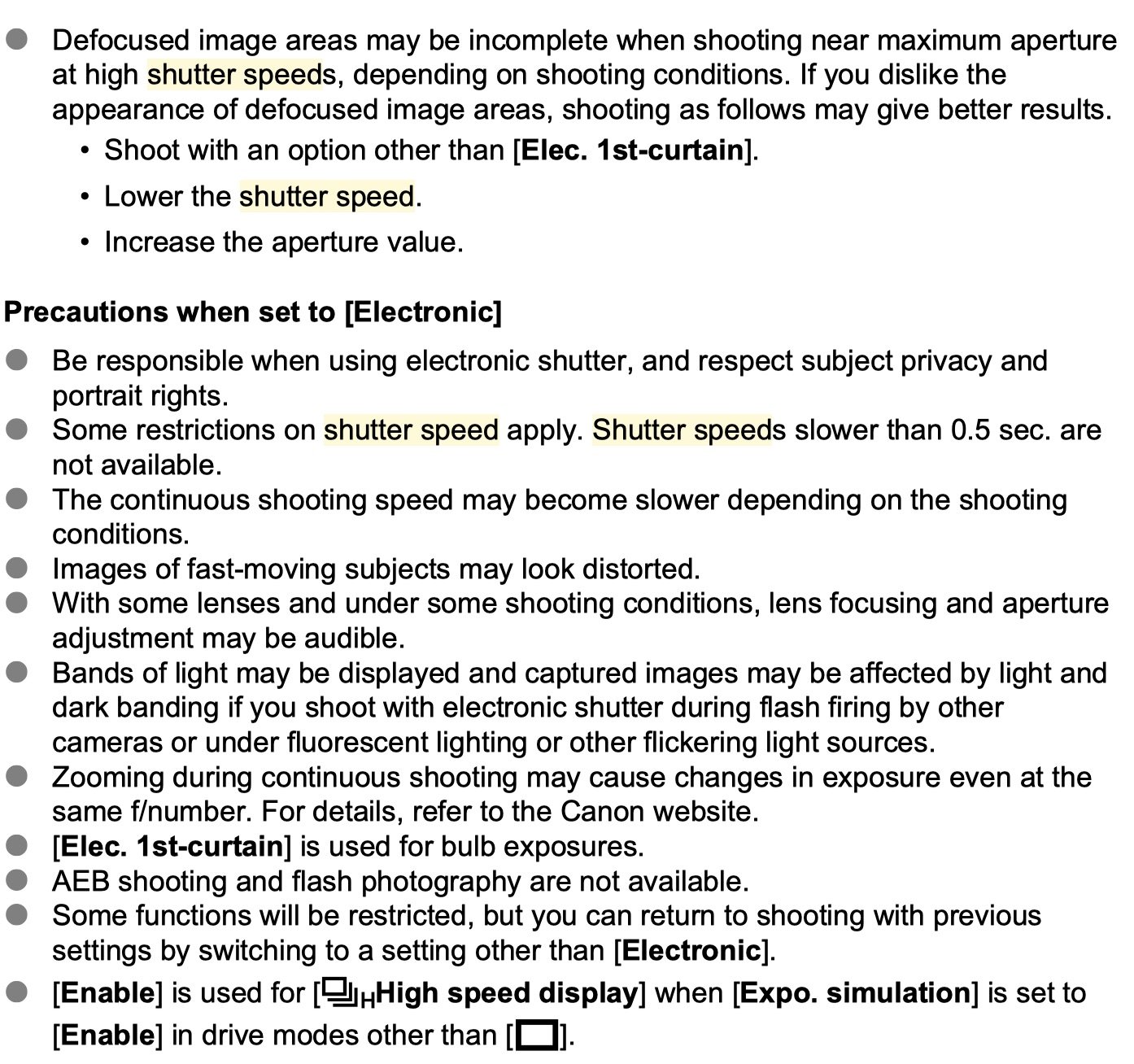

I noticed the following info in the R6 manual concerning the use of both electronic and 1st Curtain electronic. I suspect it is the same for the R5, but don't know for sure. You can see there is potential for image issue under some circumstances with both FCES and ES.
