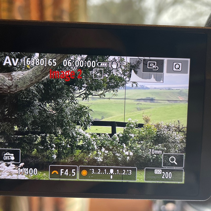

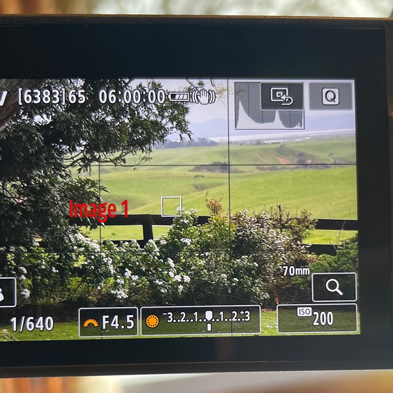

I'm finding with the R7, when I set it to single spot, that appears in the centre of the screen as it should. I take a photo, then if I review that photo and then go to take another picture, the focus spot has jumped to near the top of the screen (usually top centre, but sometimes top left). This does happen with other focusing modes too, and happens both with the EVF and the screen.
I've attached a couple of cellphone images of the screen showing an image taken with the spot in centre, then after reviewing that image, where the focus spot has jumped to for the next shot.

Looking at you example here I do see one thing. I assume you are using Full AF area? What is subject to track set to? The AF point in image 1 is in an area with very little contrast so my guess is jumped to an area that hadsome. AF is all about contrast no matter which AF modes, etc you are in. It's either there or it isn't and we have no control over its sensitivity.
ML bodies have new levels of AF. I'm in Face/Eye detect 100% of the time and will switch between people, animals and vehicles as needed. For that shot I'd probably use single point AF. I use an override method to quickly go back to single point when needed. I'm going to respond to that method in another thread to prevent duplication. I'll post a link when done.
HI, yes these were taken with full area AF. The camera was in servo, eye detect on, and animal detect. I realise that's completely wrong for this type of shot, they were just taken purely to show how the focus spot moved between shots, without me doing anything. BTW, I am still working my way through the manual!
