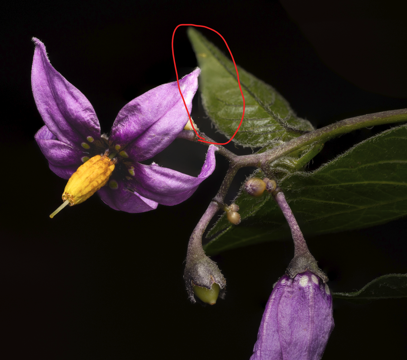

I've always used Lightroom/Photoshop combo as well. But recently I've found the results lacking because artifacts around areas that I would expect to be clean. I am considering Helicon, but I don't have the time in the next couple of months to revisit some recent stacks in order to evaluate Helicon. I do find the in-camera jpg and Lightroon/Photoshop lacking on some edges.
For example, in this focus stack combined in Lightroom/Photoshop, I would expect the leading (closest) edges of the circled leaf to be in focus.
I haven’t used Adobe for a few years but have found Affinity Photo excellent for image stacking of macro and close up images
I convert to Tiff with DXO 8 then run the stack in Affinity, I find anyway the important things are to allow a bit of focus overlap between each frame and avoid subject movement
