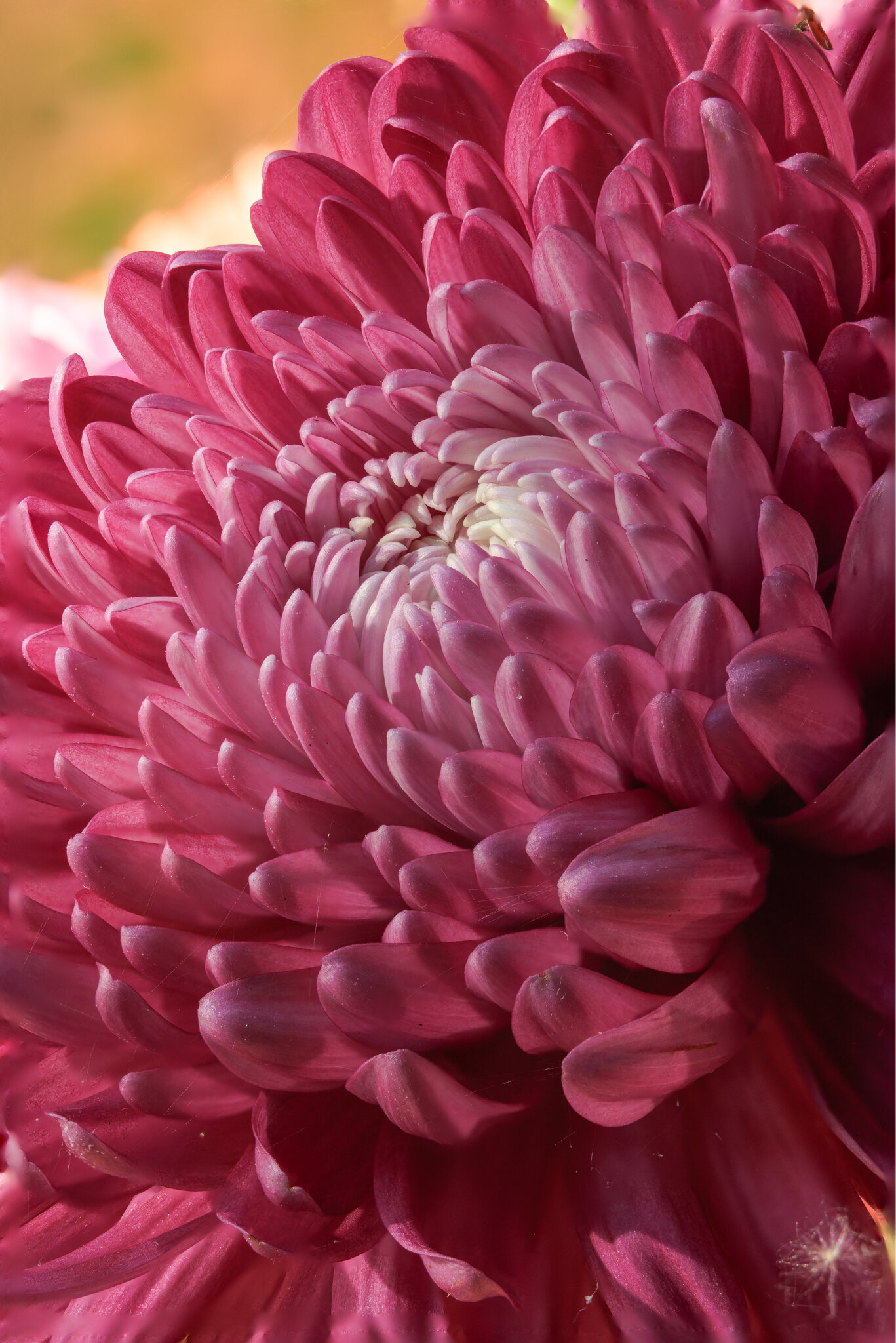

Software: Lightroom for base editing (Profile/White Balance), then Photoshop for File/Scripts/Load Files into Stack

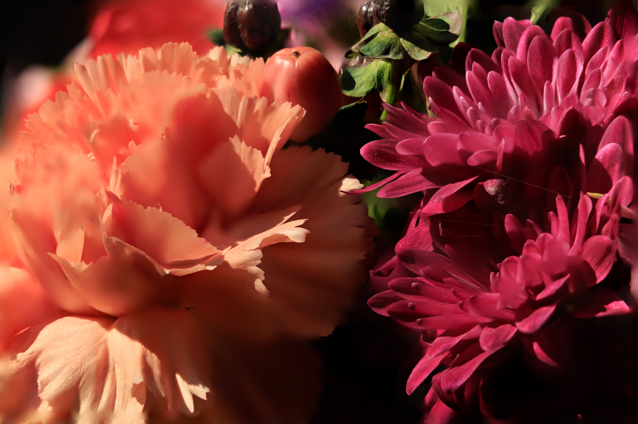

Both there photos were taken indoors one after the other, however you can see in the results the orange
flower in the first photo is totally Off-the-Mark. The second photo is more along the lines I would expect.
Camera settings: Focus increment set to 1
Any ideas? (I can not get Lightroom to "Open in Photoshop as Layers" to work)

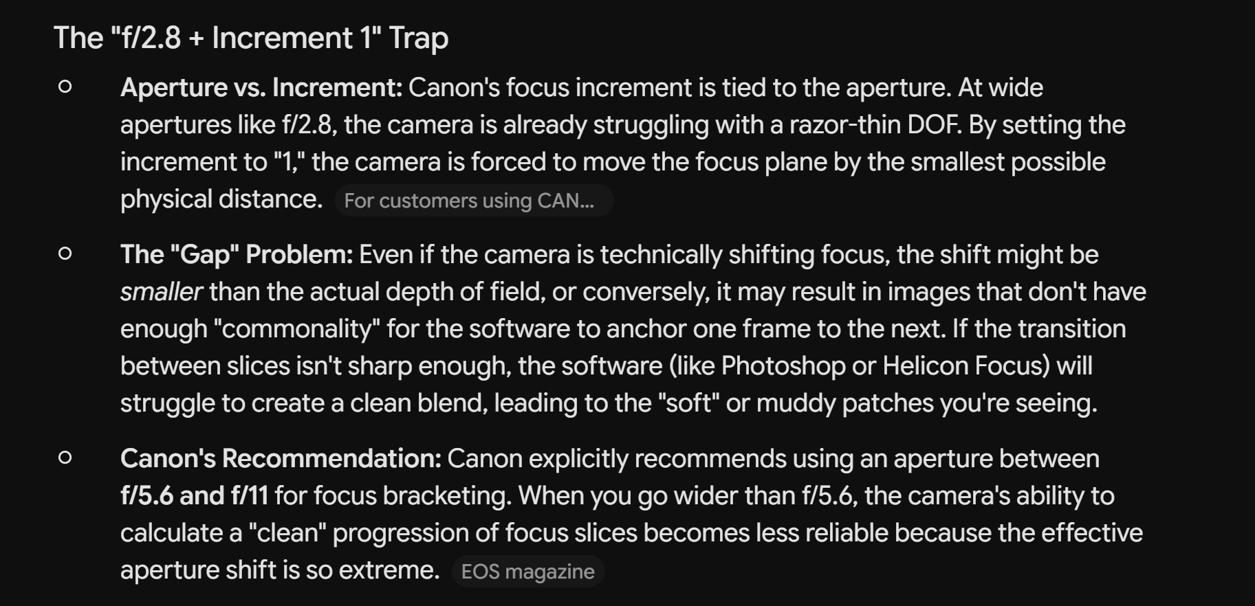

I think the problem is related to using f2.8 on the first shot. I normally have my increment setting on 3, 4 is the default. For flowers and smaller subjects, I shoot 19 shots. This is on my R6 Mark II. And even though Canon recommends using f5.6-f11, I have had good luck with f2.8 with my 105mm Sigma Macro lens with flowers.

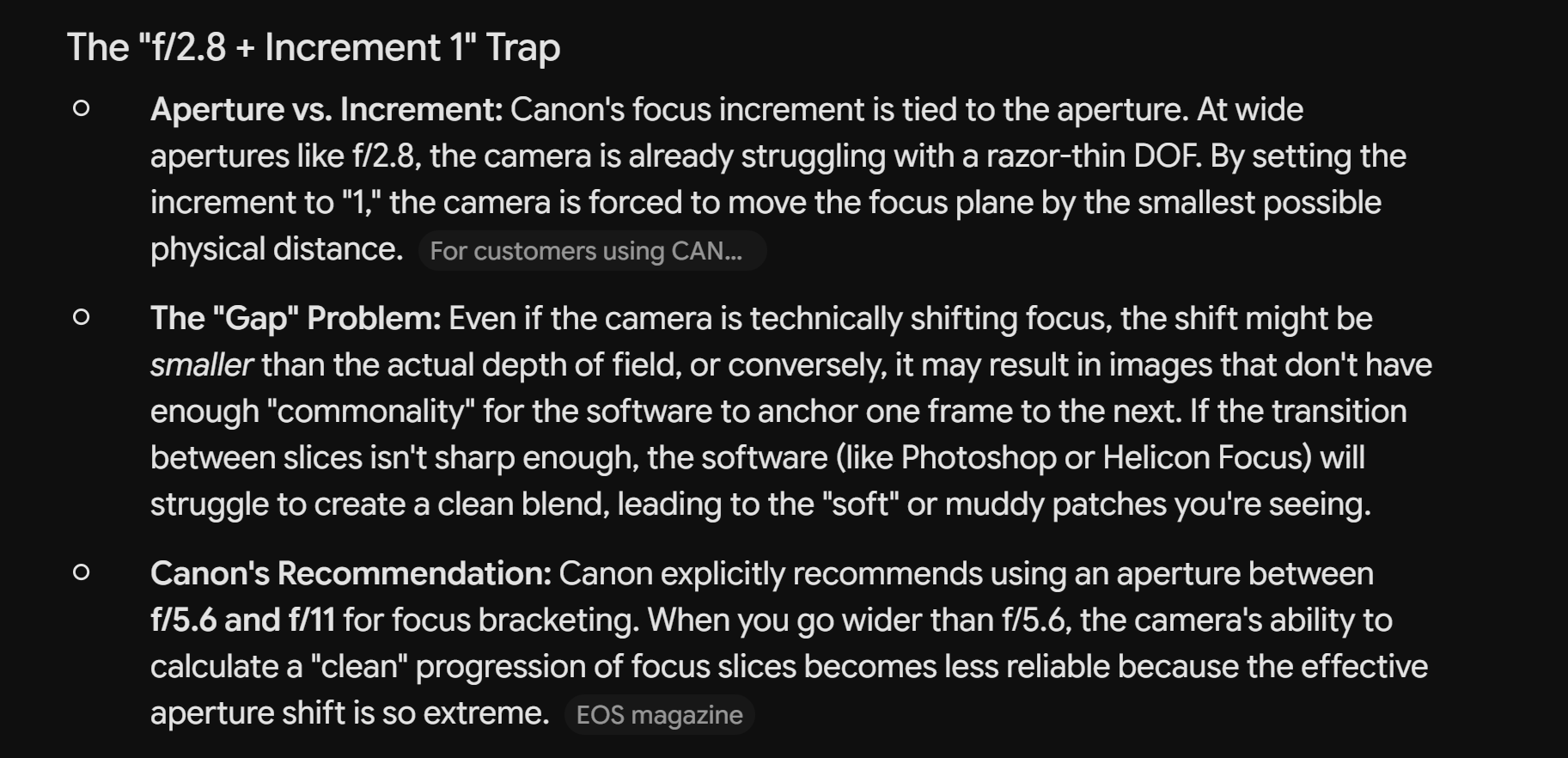

I used my Google machine and asked Mr. Google Gemini about your problem. It said your R5 and my R6 MkII are similar with focus bracketing. Here is his response, which is what I suspected:
...and thus the F/8 didn't have the same issue.

Hi, this photo is just an example. I took it at f/9, 1/30 sec, ISO 800, using a tripod. I had autofocus enabled and used increment 1, just like you did, but I think it's better to use manual focus and move the camera forward manually instead.
I couldn't do that because I still don't have a small tabletop tripod that would let me move the camera more easily.
At f/2.8, the background blur is much stronger, especially in areas where it's least desirable, and it ends up ruining the overall image.
For comparison, in dental photography I usually use a flash with f/16–f/22, 1/200 sec, ISO 200, without using focus stacking. I'm mentioning this only as an example of the aperture values I normally work with.
