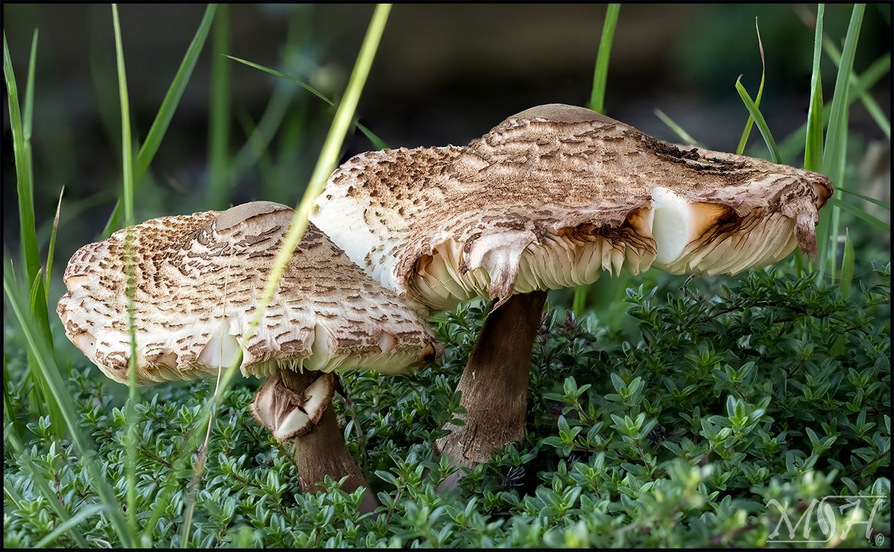

Your exposure is is the same as any other photo, I always take a single test shot to make sure I nailed it. I personally believe that it is better to shoot more frames and eliminate the ones that aren't needed when reviewing in post. Here is a perfect example of not shooting enough frames, my interval was set to 2 and I shot 30 frames, should have gone to 40 because I was short on the back end. I didn't get the complete DOF I wanted through the tail.
This one I shot 30 frames, started on the grass as I wanted it sharp but only used the first 20 because I wanted sharpness through the back of the mushroom and the background to have a nice bokeh. Again I used an interval of 2. Using an application really improves the results, it lets you select the frames you want to use and if you use Adobe PS (and I believe LRC) the process is fairly simple. There are some excellent video's on YT to learn the stacking process.
