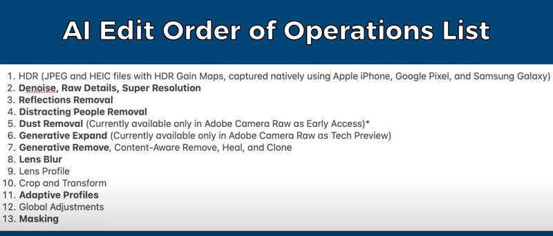

Brian Matiash has very good and interesting video about this.
The suggested order shown at 2:28. It seems like a bit of a pain but using icons themselves as tools helps. A few other things first. I don't use HDR so that is not included in my workflow. Since Lens Corrections are applied at import I decided to leave them enabled as I have not see any issues. Since LrC is a parametric developer some may find better performance while editing with Lens Corrections disabled but I have not experienced that. I've also excluded anything that does not apply to LrC so my list looks easier :)
This is my short list but I will use the list from the video for reference
1. Basically I will either apply Denoise, Raw Detaill or Super Resolution so that is always first. After Denoise runs I will tweak at 100 or 200% view.
2. For the next edits the Remove tool icon is a mental road mark. If I'm going to use any AI that is next. By the way if you do step 7 before 3 and 4 you will get the update warning.
3. Apply Lens Blur if desired.
4. Crop and Transform.
5. I apply Adaptive Color profile.
6. Then apply Global edits followed by Masking and I'll tweak both as desired. I'm not too worried about updates at this point.

That is my refined workflow that has Lens Corrections enabled. I used the steps in the video as a reference for my explanation. I combined the AI tools available under the Remove Icon in step two - 2, 3 and 7 of my process to make to make the list shorter.
Here it is at 2:28. Since 5&6 are not available in LrC and I don't PS I didn't include them in my workflow. I probably should have said I don't use 5&6 in my first post.

Yes. This video has nothing do to with any other apps except for LrC, Lr and PS. He created it specifically to help people apply AI tools in the correct order to prevent possible issues. It is kinda like using layers. Below is a response from the Adobe Community forums. Since you don't LrC, Lr or PS (I'm assuming) this is more geared towards the other members who do. I myself did use them out of order and just pressed the reset (re-build) button but after watching it I decided to create a new workflow.
"You are free to edit in whatever order you like. Realize that there will be a price in rendering accuracy and time spent rebuilding out-of-order edits".
It takes very little time to re-build an out of order edit for a single file. If you are doing events, etc then time can be an issue. The presenter has become an Adobe employee within the last year and the list he shows is the same one on the Adobe website. He has a lot of excellent videos pre Adobe employment. He presented a few simple masking hacks he said that even Adobe didn't know about. Probably why they hired him. :)

I have a habit in my workflow of cropping and masking (local edits) first. Looks like I should change that.
Which should come first in LrC, cropping/transform or masking? I've read conflicting advice on these.
It says crop/transform first but try both ways and see if you get an update warning.

There are different ways of approaching this for sure. The philosphy that I agree with most is to do the following:
1. Crop and Transform: This defines the final composition and corrects any perspective issues. This is the base image.
2. Denoise: Now you have a clean, noise-free foundation for subsequent edits and avoids processing pixels that have already been discarded. (saves time maybe)
3. Adaptive Profiles: If you use them.
4. Generative AI Tools: Generative Remove or Generative Add etc.
5. Global Adjustments: Exposure, Contrast, Highlights, Shadows etc. (but not texture and clarity)
6. Manual Sharpening or Noise Reduction: if needed for fine tuning.
7. Texture and Clarity: Global or selectively using masks
8. Masking: precise targeted edits.
I am not presenting this workflow believing that it is definitely the way anyone should do it, it is just the way which seems logical to me based on what I have learned and understood (or at least I think I understand it....haha) In the end, if you like the result, it doesn't matter how you got there.
I see your reasoning. I did seesaw between doing cropping earlier or later as suggested. Several days ago I had it near the top of the list and then decided to move to to the suggested sequence. I'm going to do a visual assessment and not apply Remove tool edits to areas that I'll crop out later. I'll see that goes. Not that it is a big deal but it was kinda nice not to have that orange reset warning illuminate several times.
I'm old dog so new tricks are always easy these days :) Doing Denoise first like I always did followed by the using the Remove tool icon a part of a mental road map has helped a lot with that. With my shortlist (which I'd still opening) I'm half way there.
It seems that Crop should be the first thing. Try this, mentally, apply a heavy Vignette and then crop 50%. Defeats the vignette.
Since vignette was not specifically mentioned then I would put it in the Global adjustments which is after cropping. Again those are suggestions and nothing has to be followed.
In my opinion, it depends on how you are adding/subtracting a vignetter. If you are using a Radial Gradient Mask then it would be in the same step as other masks. If you are using the Post Crop Vignetting in the Effects Panel, I would do it as the final step, after all other adjustments have been made. It is 100% a finishing step.
If you do a Post Crop Vignetting before masking, then Lightroom/ACR will have to include the vignette in its processing. This could potentially result in a longer AI processing time as well as run the risk of introducing some type of anomaly etc. in the vignette, which I really doubt would happen. But including the vignette in AI processing such as a mask, for example, seems to be extra, unnecessary, work for the AI. A vignette is like a watermark, it goes on top of the image so to speak. I definitely would not use a watermark....and if I did, I definitely would not want AI monkeying around with it.
Once again, the above is only my opinion and if you do things in a different order and you like the result, then that is what is best for you...in my opinion... :D
