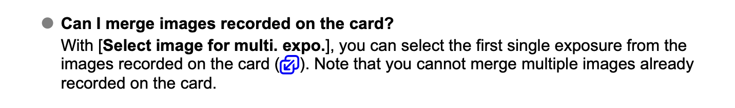

Not sure about the R7, but the R5 manual says this:
I've never tried it but the R5 manual makes it sound like you have to use images recorded at the same time.
