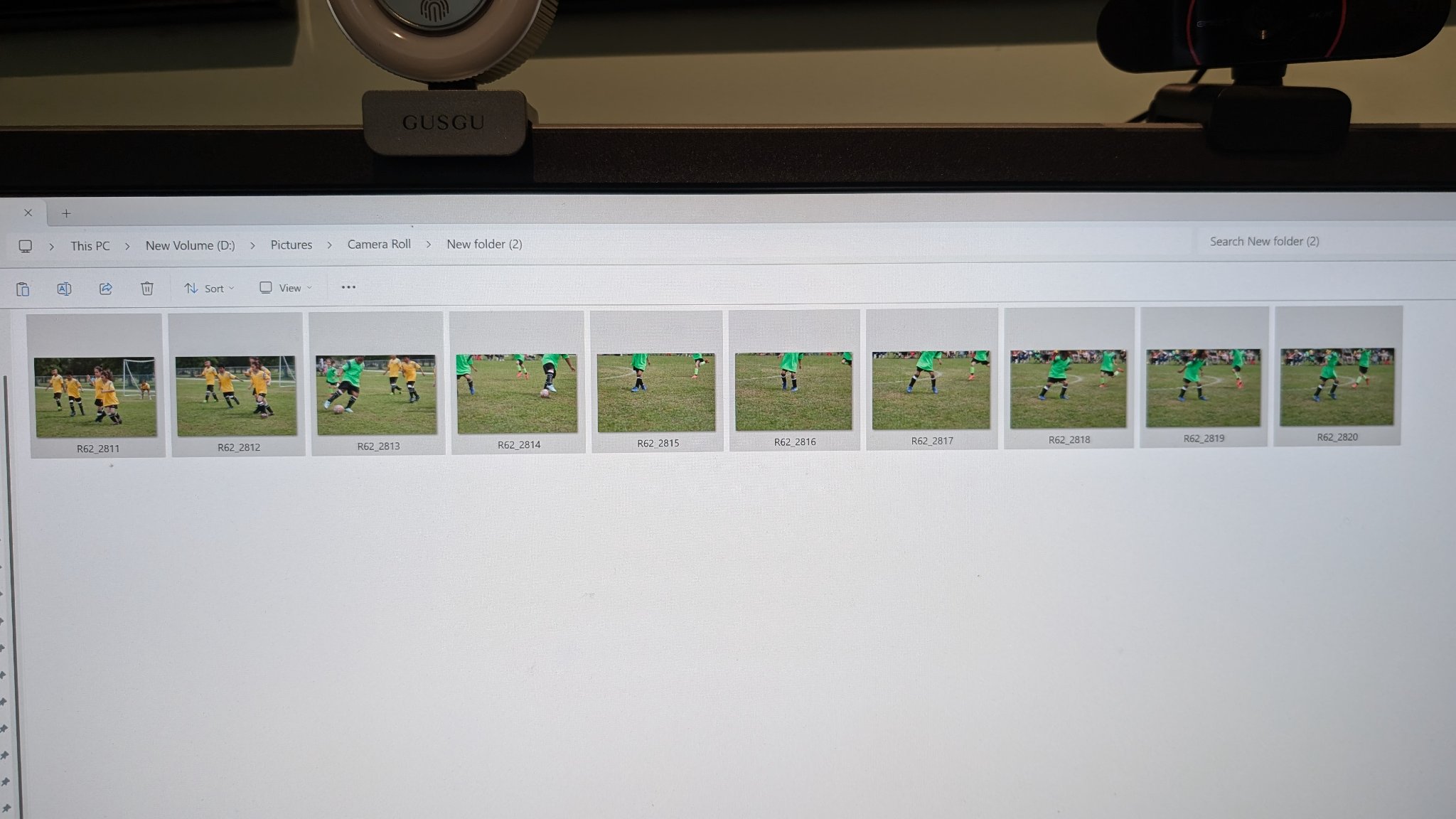

Not sure if anyone else has had this issue with their R6 MKII. I have had it happen a few times when shooting in the high speed burst and high speed burst + mode several times recently. I shoot a burst and stop firing and the camera keeps going for 10-15 frames or more.

Several times with the R6 MKII I shot a burst and released my finger from the shutter button and the camera kept firing.

I looked online and there were some posts in the Canon USA user's forum. I found several posts from last year, exact same thing happening. Lots of suggestions about doing a factory reset and then making button changes one at a time until the problem happens but that didn't seem to solve anyone's issue. Most of the OP's said they sent the camera to Canon and they either replaced the shutter mechanism or the mother board or some other component, it fixed it for some but not for others. Seems everyone who had the problem was shooting burst mode with E shutter and BBF so their might be a link.
