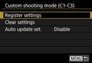

My first guess is that you have "Auto update set" set to enable.
Good guess, but no, its disabled.
Hmmm. I just went into my camera and set the DOF button to DOF for C3 and Raw Burst for C2, switched back and forth, no problem. They retained the settings. Just to be clear with what I did exactly, I went into the menu to the Customize buttons option, changed the DOF button to DOF (mine was set to something different), went into the menu to the Custom shooting mode and saved it as C3. I then went back in the menu to the Customize buttons option (didn't touch anything else), changed DOF to Raw Burst, then went back into the menu to Custom shooting mode and saved it as C2. I then tested these changes by turning the dial mode back and forth between C3 and C2 to see if these customs settings had been saved. They had. One point: my Custom shooting modes are set under M. Not sure if that matters or not.
