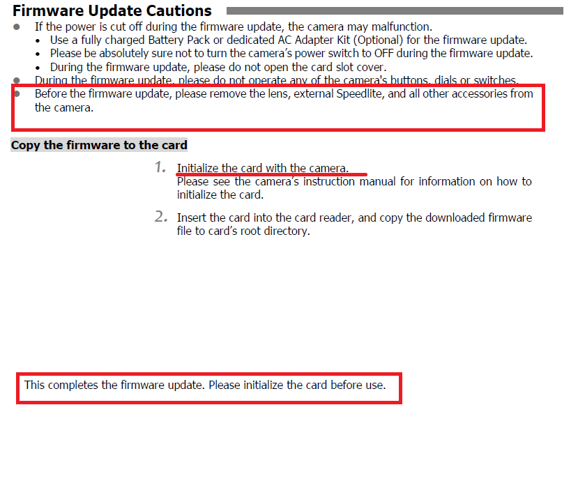

Here is some things people miss:
First make sure you are downloading the correct file for your OS.
macOS file name is eosr7-v160-mac.dmg
Windows file name is eosr7-v160-win.zip
What is your OS?
On the Canon Website after you select which Computer OS Version you are using, scrolling down the first Firmware is for macOS and the one below that is for Windows

Once you have the correct software remember to Read, Understand and Follow the instructions carefully.
