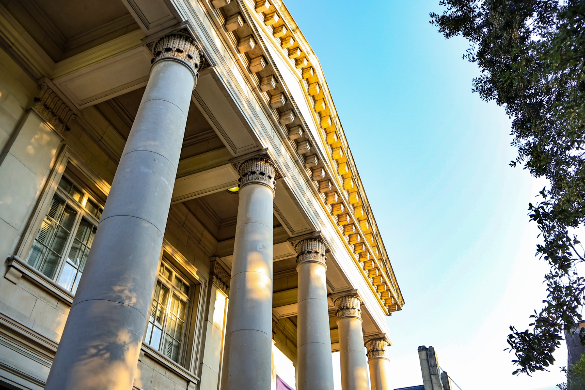

Thanks for explaining that. I have a photo that has been bugging me for a while. There is some banding in the blue sky, and I can’t figure out why. Your explanation makes sense. I have messed around with it in Lightroom, and no luck. What can I do, if anything, to avoid it or fix it? I took the photo with my R50 and my 18-45 kit lens shortly after I got them, if that helps. See the blue sky below.
It looks like the sky was overexposed. There are quite a few pixels that are maxxed out and don't have faithful data. Given that it is a JPG, it will be difficult to fix.The original is a jpeg. Can you recover EXIF info from a jpeg?
I have the sky saved as a mask, and the only instance where I can remove the bands is when I jack up the exposure in the sky, and that just turns the sky white. How do you add noise? I went to the denoise slider, and took it to extremes either way, and can’t tell much difference. In retrospect, this photo may not have been the best example to use.
Thanks for your expertise and patience.
OK!Thanks for the analysis. Looks like I need to pay more attention to exposure. This particular photo was taken a while back before I was aware of the histogram, and what it does. Again, thanks for the advice.
