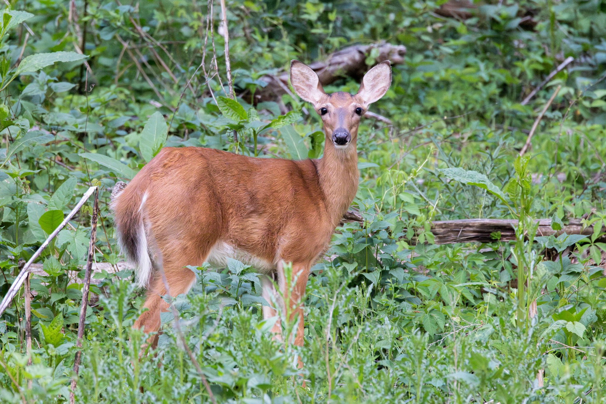

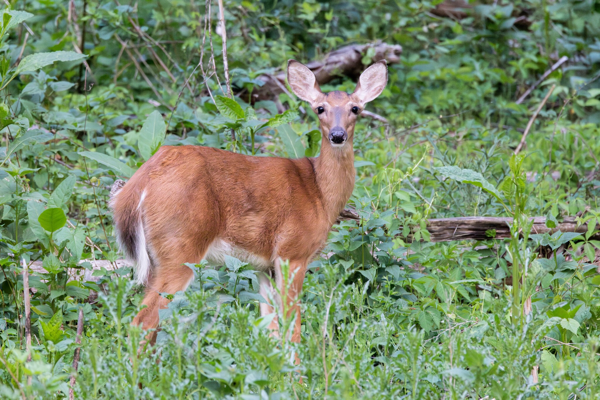

Below are before and after versions of a photo where I used Photoshop's Generative Fill to remove a couple of annoying branches. My feelings are mixed. On the plus side, it was very fast and better than I could have done myself. I'm not good at Photoshop's clone tool. On the down side, if you pixel peep, it the modified areas don't match the noise and grain of the original, making the edit much more noticeable. Overall, it is hard to tell that an edit was made.
What are other folks' opinions on the AI Generative Fill and am I missing a useful technique?
This version was only edited in Lightroom.
This version used the AI Generative Fill to remove a couple of sticks.
How did you instruct the program to remove and replace those specific sticks? Was is a difficult / tedious selection process?
It was only a couple of minutes... very easy, very fast. I used lasso tool to draw an outline around the sticks, clicked Generate Fill, and did not write any text in the content box. This way it perform an AI based content aware fill. In a couple of seconds, Photoshop has three options for fill to select from. I did the stick over the deer's rump and the stick behind the deer as separate operations on their own layers. I did no further touch-up.
What I didn't like about it is that is removes grain and noise from the modified area. It is like masking a thin area and doing 100% Denoise and it's noticeable if you zoom in.

Can I ask why you didn't use the new 'Remove Tool' in Photoshop - I'm finding it easy (and effective) at removing unwanted bits. (My tips for using this are treat a little bit at a time and deal with foliage linearly if possible).
Example using Remove Tool (I kept the NR off so you could assess any changes to the original grain/ noise). 1. Original, 2. Various bits of foliage removed, 3. Do we really need the deer?

Phil, below is the same pic of a deer, this time with the sticks removed with the Remove Tool. I am much happier with this and it was even easier. The right tool for the job. Thanks again.
Ephestia, I tried the log with both. The Remove Tool did much better, but it still couldn't do an acceptable job, imo. I think the log behind the ears it to far in the background and too blurry for it to do a good job.
