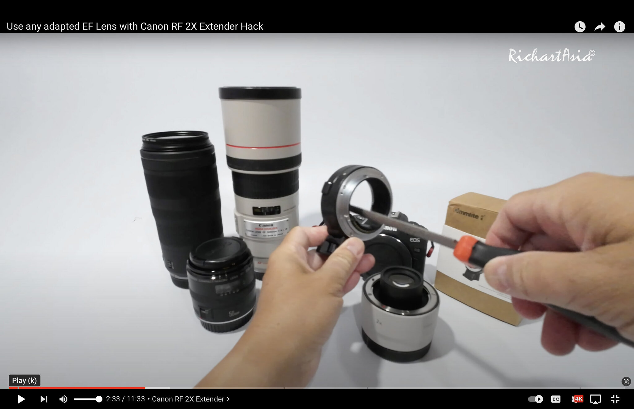

You can, but you have to modify the RF/EF adapter, the 3rd party Commlite version reportedly requires the least grinding and filing of the baffle.

I have all of the Canon components listed above and can answer with certainty:
  • The Canon RF Extender cannot be joined to the Canon RF/EF Adapter.
Modify the RF/EF adapter (by) grinding and filing the baffle.
That sounds interesting, but don't go anywhere near that option unless you have advanced skills in precision machining.
I have no idea whether the resulting assemblage would be optically acceptable. Comments?

David, I won't be trying this hack anytime soon. My biggest concern would be taking too much off the plastic ( and that picture is not exactly precision machining) and exposing the contacts and any missed small particles of plastic getting into the camera body. I would rather stay with my EF versions which I know work with no modifications. Besides, I am getting too old to replace my EF lenses with the RF's.
