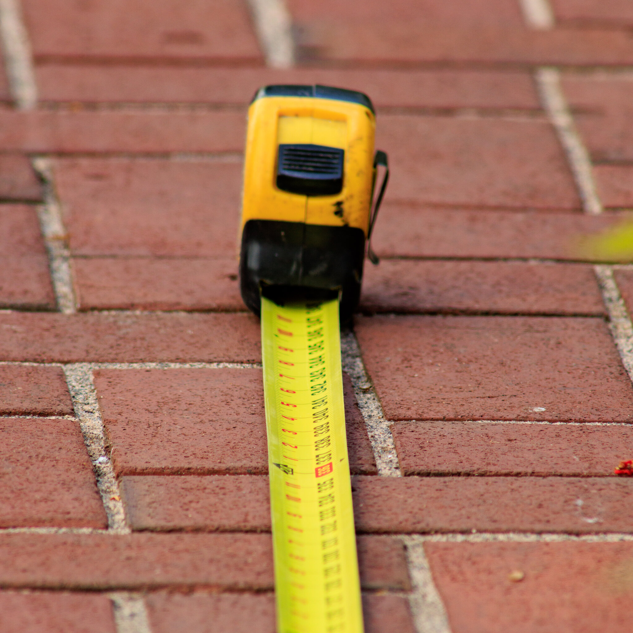

My FD 800mm lens minimum focusing distance is about 552 inches. I thought...but what if the subject was closer? So...

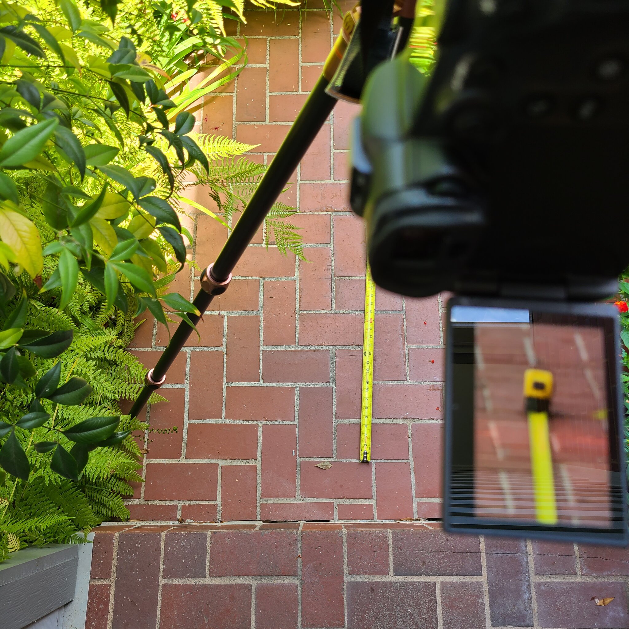

I added 29mm (11mm + 18mm) extension tubes to the setup and measured the new minimum focusing distance (about 338 inches):
As you can see by the photo it is much, much closer than 552" away.
