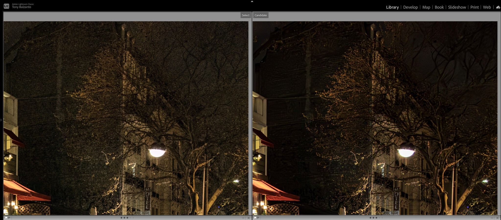

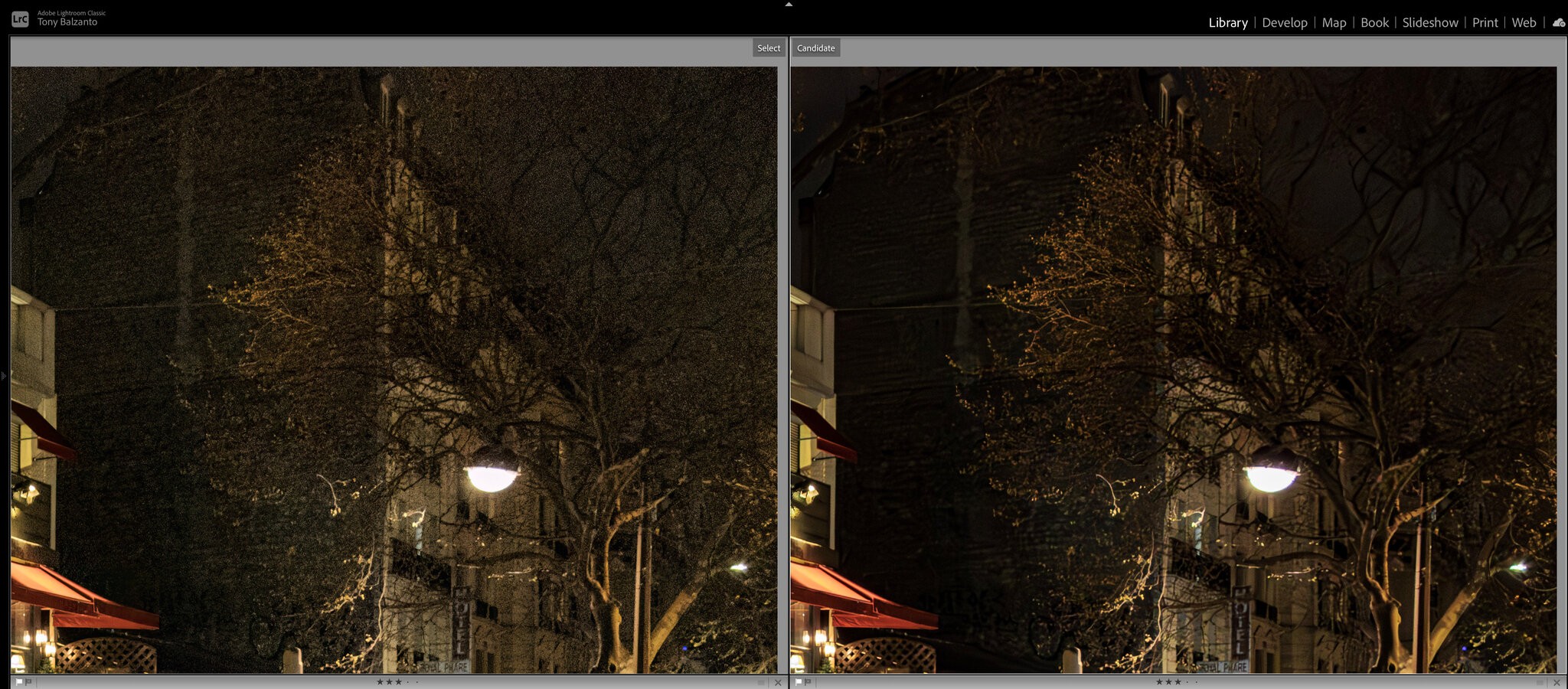

Just compared Adobe to Topaz Photo AI on an R7 night shot at 6400 ISO. The original has a lot of noise. Care to guess which is the Adobe and which is the Topaz? I know a screenshot isn't the best. Adobe was set to 50%; Topaz was on its auto settings. Adobe is on the left and I am quite impressed. Now if they could only fix the bug I've had open for a year where Lightroom Classic to Photoshop Edit In workflow is broken on sporadic systems.

I must admit I was more than a little sceptical about whether Adobe Denoise could be competitive straight out of the box, but so far it's producing very impressive results. (If I'm perfectly honest, I'm a bit shocked how good it is).
I'm not sure I'll be ditching DxO or Topaz Labs just yet, but I'll certainly be comparing the results from the various options (where time permits!) - and I won't be surprised if Adobe is 'the winning solution' in a number of instances.
I've been using 50-75% strength on ISO 3200-6400 raw files with very good results. Further testing will follow in the coming days (and weeks!) I'm sure... :)
(I've not come across your Lr C -> Photoshop issue, but good luck on getting a fix).

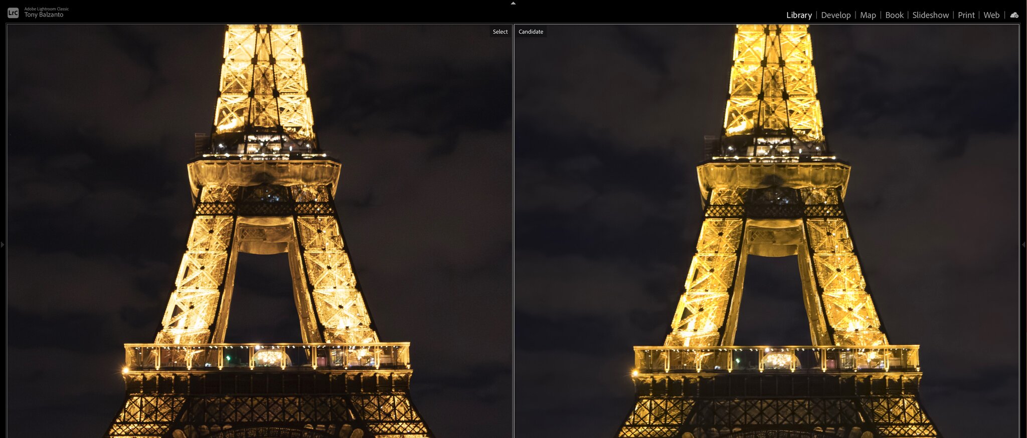

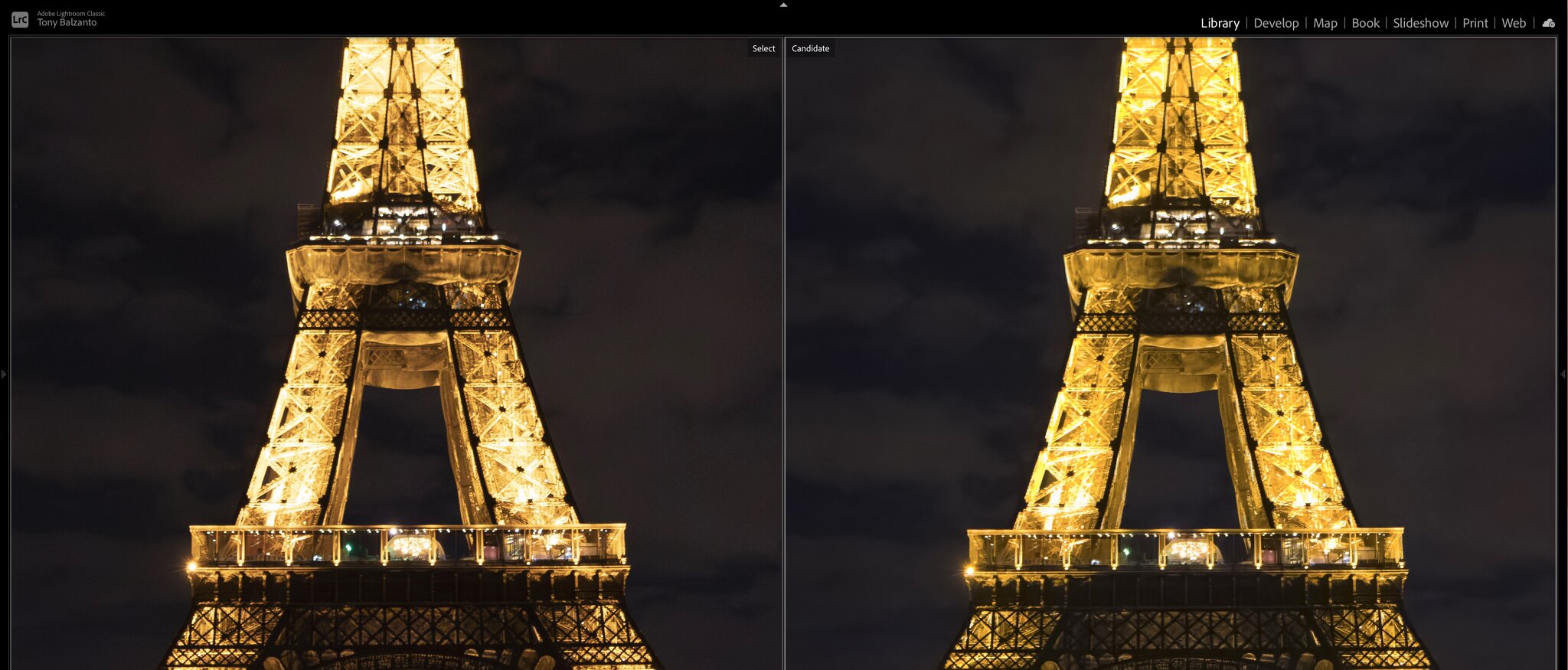

In this example, Adobe beats Topaz by correctly identifying the noise in and behind the trees, which seems to have confused Topaz Photo AI. When I get more time, I'll run some comparisons to Topaz DeNoise AI. I went with Photo AI because that's where Topaz is putting all their development efforts. If Adobe does the same with sharpening, Topaz may have to shift their business model back to "effect" products rather than processing. Personally, I really wish Topaz would bring back their classic effects and update Adjust AI and Studio.
Photo AI on the left; Adobe on the right. R7 at 6400 ISO
