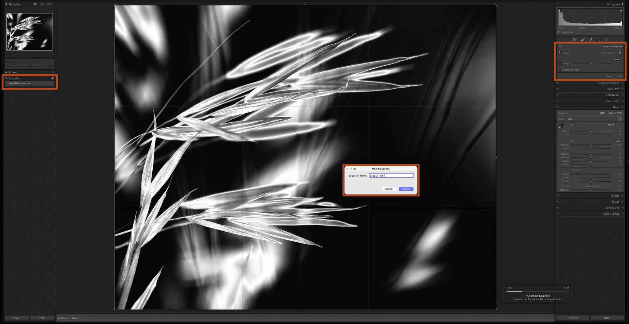

1. Use "Snapshots' to quickly compare different crops/ adjustments/ edits etc... I find this function a really effective way to compare/ demonstrate different options.

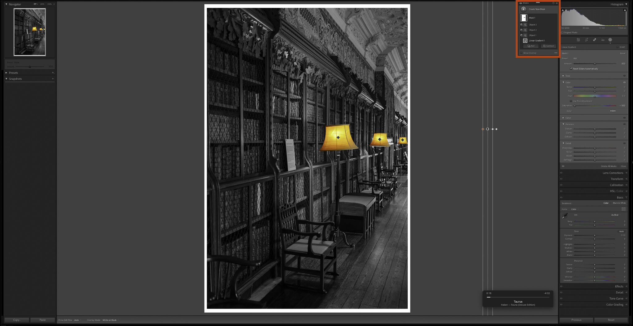

2. Draw a Linear Gradient off an image to apply a mask evenly across it, then make 'global adjustments' and selectively modify them (Add/ Subtract/ Intersect). In the below example I set Saturation to -100 to produce a B&W style image, then 'Subtracted' from the mask using Objects to selectively add colour back. You can get quite creative using different permutations of adjustments/ modifications. (Other global masking options are available, but I find the Linear Gradient is easy).

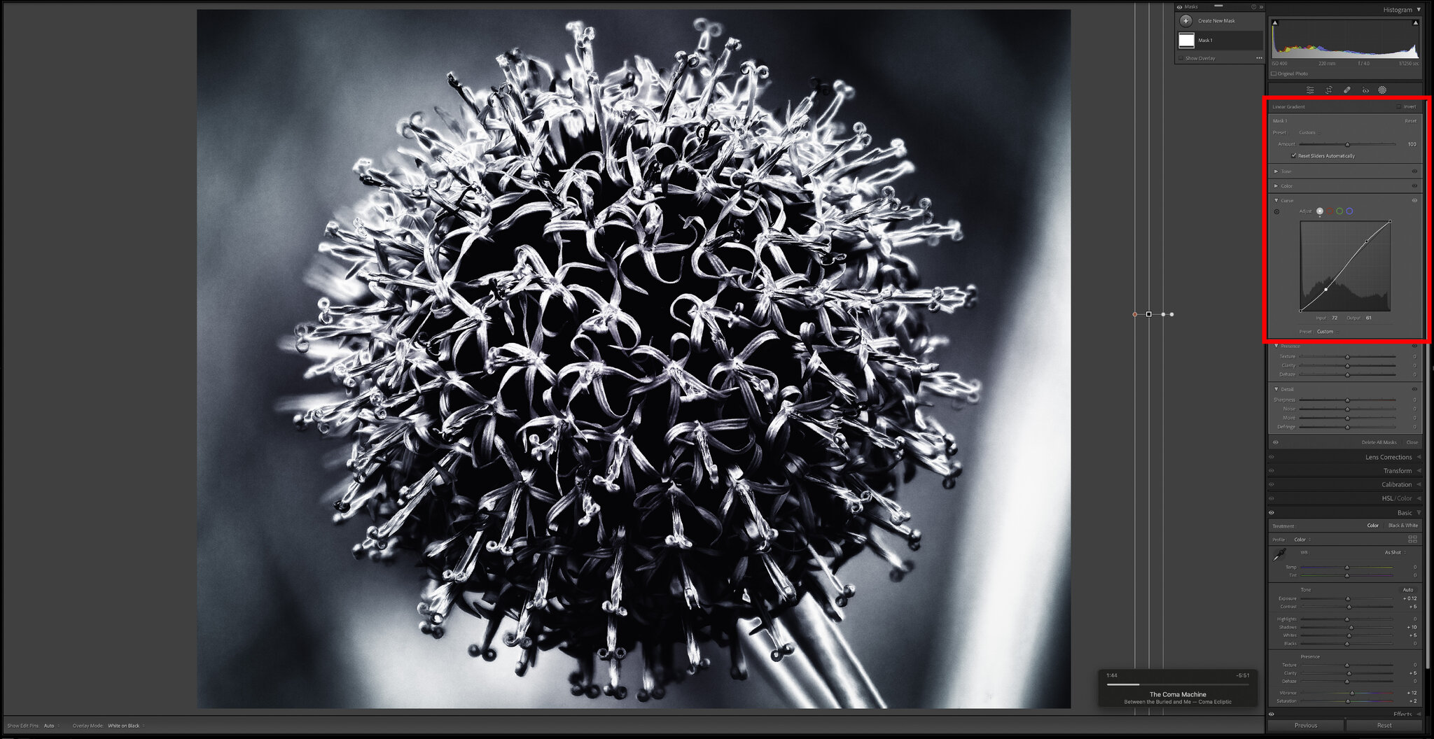

3. Bonus tip - In the below example I've used this method to apply a Curve adjustment (now available with the latest update) to the entire image and because it's a 'mask' I can also adjust the 'Amount' - something which would not be available using the normal Tone Curve tool in Lr C. I find this gives me fine control over the Curve adjustment without any frustrating fiddling about with points.
